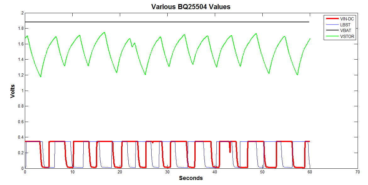

  • Unfortunately, I don't have the equipment to measure all the parameters at the same time, but I was able to measure them all separately and then put them on the same graph.
    Below, is a graph of LBST, VBAT, VSTOR, and VIN_DC. As can be seen, LBST and VIN_DC are essentially the same, but because I measured the two values at different times, they do not overlap correctly. Also, I precharged the supercap to about 1.8V, and then connected it to VBAT. As can be seen, there is no charging.
    Here were the order of events:
    1) Discharged VSTOR to a few millivolts.
    2) Connected VIN_DC source
    3) Connected super capacitor (precharged to 1.8V) to VBAT
    4) Measured VIN_DC/VSTOR/VBAT/LBST consecutively
    Any idea what might be causing the super capacitor not to charge?
    Brock
  • From this graph, it appears that you do not have enough input power to exit cold start because VSTOR has not risen above 1.8V.

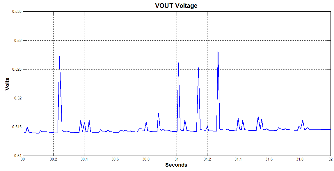

    I recently received the BQ25570 EVM, and it has worked wonderfully so far.  Thank you for this suggestion.  I simply placed my super capacitor at the VOUT terminal, shorted VSTOR to VBAT, and applied my source to VIN_DC.
    As my 3V 4F super capacitor was charging yesterday, I noticed some interesting behavior.  The super capacitor voltage seemed to spike up and then drop quickly every second. Here is a zoomed in graph of what was happening.
    Do you know if this is normal behavior for the VOUT terminal of the BQ25570, or if this is due to some sort of mismatched RC constant, or something like this?
    Brock
  • I expect some switching ripple but more consistent than shown above. Can you use an oscope to zoom in on VSTOR, LBUCK and VOUT over 3 of the different sized pulses?
  • Jeff,
    I recorded these 3 voltages from VSTORVOUT, and LBUCK simultaneously.  Below are the results.  For LBUCK, I measured from the TP3 node on the BQ25570 EVM.  I'm not sure if this was the correct node or not, but on the schematic online it appears to be correct.
    I am using a 3V 4F Super Capacitor, which is connected to VOUT. The super capacitor has internal resistance of 0.3 ohms.  I have VBAT and VSTOR shorted together.  The input source to VIN_DC is definitely varying by time.  I included a graph of what VIN_DC looks like.  The graph below was measured at a different time than the graph above.
    Might my input to VIN_DC be a cause for the unstable charging for my supercapacitor?
    Brock
  • The LBUCK node doesn't look correct.  It should be pulsing well above 0V.  The waveforms are reasonable.  VIN_DC will have repeating pulses up to the sources open circuit voltage every 16s.  From your plot, it appears your source's open circuit voltage is 2.5V and you have the MPPT voltage set to ~1.9V.  The down pulses show your source collapsing at random times but then recovering.
