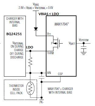

we are developing single cell liion charger + fuel gauge solution. We need both charger and fuel gauge to measure temperature of the pack and we would like to share single thermistor by both charger and fuel gauge. Our fuel gauge is MAX17047 and our charger is TI BQ24251.
Fuel gauge measures temperature on AIN pin by temporarily (for 10 ms every 1400 ms) connecting bias voltage to THRM pin.
Charger needs to continuously supply thermistor from LDO pin.
There will be no problem, when LDO is on, because VBIAS < LDO. However, when the charger will be off and LDO will also be off, VBIAS will be shorted to the LDO of the charger. We measured 100 - 150 uA current flowing into LDO in this situation. Is it safe?
Is there a better solution for thermistor sharing between BQ24251 and fuel gauge?
  • Hello Martin,
    I would recommend placing a reverse conduction diode from the LDO to the thermistor resistor divider. This will eliminate the reverse conduction and any issues that it would create. This would diode OR the bias voltage much like what you are doing to protect the rail that you are pulling the bias from.
    However one thing that I would be concerned about is that there is going to be a non-negligable amount of variation in the biasing voltage with the LDO output 4.9V and the VTT being closer to 4V or possibly less a large amount of error will be introduced between the two bias sources. This variation in the bias voltage along with potentially incongruent sensing thresholds could create a recipe for havoc in your system. However after looking at the Maxim gauge it looks like you can work around this bias variation by changing the temp offset as discussed on Pg. 39 as the bias voltage changes.
    The sensing thresholds for the BQ24251 are clearly provided on Pg. 8 relative to the voltage from the LDO:
    The safety thresholds threshold for the Maxim part are user programmable as discussed on Pg. 32.

  • Dear Ryan,
    thanks for your answer! Actually, there is no problem with the reverse protection diode for MAX17047, as MAX17047 eliminates diode drop by measuring ratio of AIN to THRM producing temperature output independent of bias voltage magnitude.
    However, I guess, placing reverse protection diode in LDO rail will significantly move all the temperature thresholds of BQ24251 and I think there is no way to compensate it, so NTC monitor of BQ24251 will be unusable.

  • Hello Martin,
    Regarding your statement about the shift in the TS thresholds. The thresholds with the device stay a function of the LDO voltage but you would just need to adjust the voltage divider calculations to match those threshold voltages at the proper temperatures using the slightly lower post diode rail. With that in mind I do not see that being a problem and would allow you to use both the charger and gauge NTC monitors.

    thanks. I'm trying to select proper resistor values that will work both for fuel gauge and charger. I found out that the parallel resistor to the thermistor (R3 on page 29 in BQ24251 datasheet) mustn't be used - fuel gauge isn't able to compensate its influence.
    What is the beta and R0 of termistor that doesn't need R3 resistor? I tried beta = 3500 and R0 = 10k along with R2 = 10000 but obviously I'm not able to get proper TS thresholds for all temperatures.

  • Thanks for that calculator. However, the Solve button doesn't work for me in LibreOffice and Excel 2010 (macros enabled).
    I'm able to get reasonable small error for HOT and COLD thresholds with R0 = 10000, beta = 1800, R2 = 12000 (and R3 = infinity).
    Is there an error in datasheet? You write there that R3 is not neccessary when beta near 3500 (page 29) which I think is not truth.
    So the problem now is that NTC's with beta = 2000 are not available. The conclusion might be that thermistor sharing between charger and fuel gauge is not possible.
