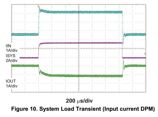

Let me ask about DPM function. In fig.10 in datasheet, IOUT is reduced due to DPM function, then I'd like to the operation when the ISYS will go up more and IOUT will go down below zero. Does the IIN remain 3A (IDPM) and turn on BATFET to discharge battery?

  • Hello Sonoki,
    Typically the feature that you are asking about is called "Supplement Mode" in other chargers. Looking at how the BATFET operates and reviewing other aspects of device operation it appears that the only way to have the battery provide additional power to what is provided from the adapter to the system load is to have the system load attached directly to the battery rail as discussed on Pg. 2 of the datasheet.
    The discussion of the "System Power Selector"starting at the bottom of Pg 18 of the datasheet discusses how the power provided to the system rail in Figure 1 is an exclusive OR so that ACDRV and BATDRV are never closed simultaneously in fact a dead time is incorporated to prevent shoot-through.

    Thank you for your comment. I understand that the ba2417x can be in supplement mode if it's configured like Fig.2 in Pg.5 of bq24171 DS. However I'm not sure the case of the multi-cell application configured like Fig.1 in Pg.4 of bq24171 DS. In this case, the DPM current (IDPM) is set to 3A, so the input source can provide the total current up to 3A for system and battery. So now I'd like to discuss about the case of "IDPM < Isys". Following is my expectation at "IDPM < Isys" is happened.
    • System require 3.5A.
    • Vsys is dropped because the input power is limited (IDPM=3A in this case).
    • Vsys is dropped below Vbat, then the body diode of Q3 is turned on and battery start to provide (discharge) 0.5A for system
    Is my understanding correct?

  • Hello Sonoki-san,
    In the case where the adapter voltage is below the battery voltage the device will be in sleep mode. Also is discusses how the transition between the Q1/Q2 and Q3 is a break before design so that there is never a direct conduction path through all three MOSFETs.
    This is to prevent reverse discharge cases.
