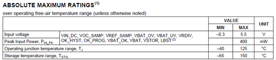

If have BQ25504's VIN_DC pin connected to a constant-voltage source, How many current will the IC draw from the source ?
  • Hello Jorge,
    There are two places in the datasheet that can help answer this question. The first is the input power limit (400mW) seen on Pg 2 in the Absolute Max Ratings:
    The second place is in the input current limits discussed in the electrical characteristics on Pg. 3:
    Let me know if you have any other questions.

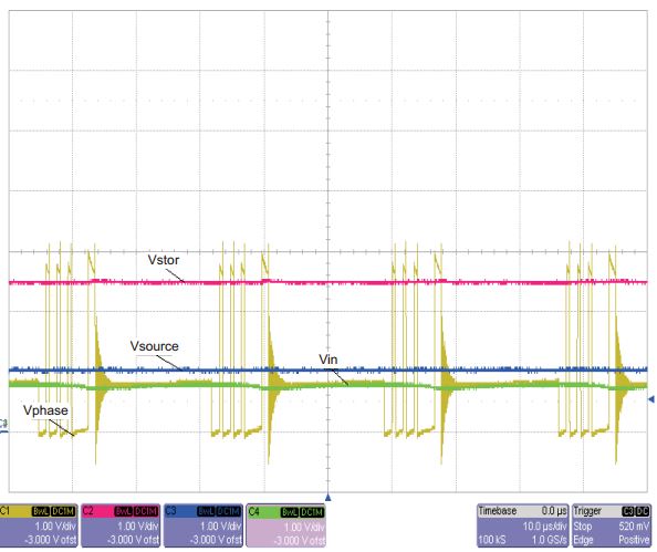

    Regarding the Pulse Frecuency Modulations (PFM) switching mode which is used  in BQ25504, I took the following picture from the EVM, my question is, Which frecuency is modulated, the frecuency between each 'burst' or the burst frecuency ?
    Also, the datasheet has a parameter descibed as 'Boost converter mode switching frequency ', which its values is 1 MHz, Which frecuency is it?
  • The part starts a switching cycle if VSTOR drops below VBAT_OV.  It turns on the switch until either VIN_DC drops to the MPPT point or the power FET hits the peak current (200mA typical/300mA max).  If the input voltage does not drop, the fastest it will switch is 1MHz.  It is does not modulate frequency.
  • Sorry, this is the picture I mentioned before
    If the IC does not modulate frecuency, what does PFM mean ?
  • PFM is used as a synonym for hysteretic operation.  It simply means the switching frequency will vary depending on the output voltage and output current until to some maximum switching frequency, in this case 1MHz.  The alternative is pulse width modulation with fixed switching frequency.
