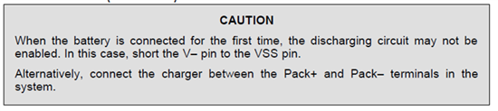

  • There is a Caution note in the datasheet that covers this:
    This also applies for a battery that is deeply discharge and the device gets powered off because of it. A charger would need to be connected to turn it back.
    We have discovered all this, and I agree completely.  We have this part on our board as additional protection beyond the battery's protection circuit.  We really like this part.
  • Have same problem. I think the main reason i that when connecting battery, MOSFET is turned off so there is voltage difference between BAT- and GND sensing on V- pin, so BQ assumes that there is an fault state. Probably MOSFET does not turn on before pre-programmed delay. In my application i am using another MOSFET than suggested in datasheet (with less total gate charge), but i think the main problem is that gate signal in my PCB design is too long (i have not confirmed that on oscillogram yet). For now system works with 200 kOhm resistor placed beteween BAT- and GND, what forces unfortunately current flow at the MOSFET turn-off state.
