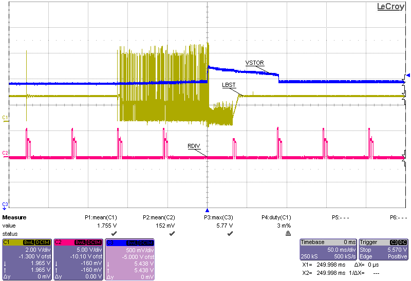

we're evaluating the BQ25570 on the TI EVM for one of our applications.
The following setup shall be used:
  • The energy source is a coin cell (typical inner resitance 10-30Ohms).
  • The storage element on VBAT is a tantalum capacitor (around 4.5mF).
  • The storage elements voltage should be as high as possible (5.5V).
  • The MPPT setting should be quite high, so that peak currents are drawn from the tantal cap (not the coin cell).
  • Output voltage: around 3V.
The following problem arises:
  • When setting the VBAT_OV to levels above 5V, the Output seems to disconnect (i.e. 0V at output) in unregular intervals.
  • I also observed that the output sometimes rises from 3V to 5V when applying pulsed loads.
  • These problems seem to vanish when setting the VBAT_OV voltage below 5V.
The EVM has the following configuration:
  • VBAT_OV = 5.3V (ROV1=390k, ROV2=750k)
  • VBAT_OK = 2.82V
  • VBAT_OK_HYST = 3.06V (ROK1=510k, ROK2=680k, ROK3=100k)
  • VOUT = 3V (ROUT1=510k, ROUT2=750k)
  • MPPT = 93.7% (ROC1=10M+4M99, ROC2=1M)
  • 4.5mF Tantalum Cap connected to J8
  • 100uF ceramic cap connected to input (solderd on C8 on EVM)
  • J1 - power supply 3V, 10R series resistor (simulating coin cell)
  • JP1: closed
  • JP2: /EN = GND
  • JP3: VOUT_EN = VSTOR
  • JP4: open
  • JP5: open
  • JP6: open
Maybe you have an idea why this "strange" behaviour occurs?
If you need further information, don't hesitate to ask.
Reinhard
  • Where are the pulsed loads applied, VSTOR or VBAT? How much current are in the pulsed loads?
  • Pulsed loads are applied at VOUT. Peak current is ~26mA, applied for around 600ms, applied every few minutes.

  • After having my technician clean the EVM that I modified to match your design, I saw the same infrequent overshoot so flux is not the problem.  I also reduced the top VBAT_OV resistor so that VSTOR=5.0V and did not see the overshoot.  I was able to capture the attached waveform, which shows the IC momentarily going into cold start.  Can you repeat the attached waveform?  After discussing with the IC designer, our theory is that high amplitude switching noise is false tripping the cold start circuit.  I plan to add additional decoupling capacitors (~1nF) to see if that prevents the cold start false trip.
    Regarding using low impedance coin cells, keep in mind the following:
    1.  The peak input current will be ~200mA unless you use MPPT set very high so that the battery's internal impedance trips the input voltage regulation (i.e. MPPT) circuit.
    2.  The MPPT sample period is for 256ms every 16s.  Is your load current going to collapse VSTOR during this time?
