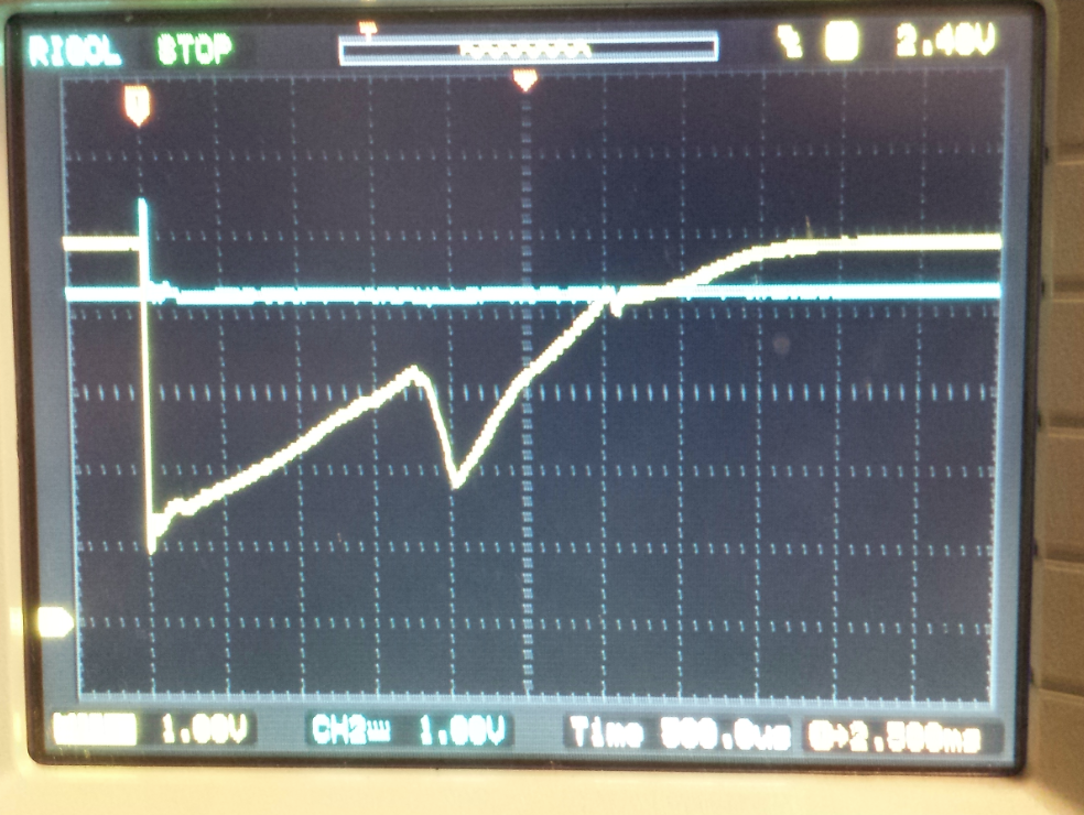

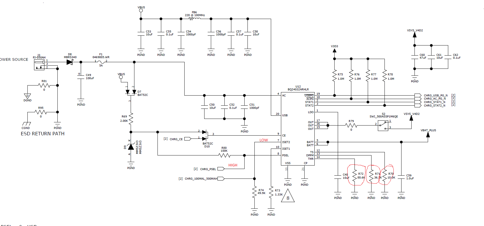

Dear Support,
I am using the BQ24032A.  Attached is my schematic and a scope shot captured at the OUT pins of the system output.
I have a battery connected to the charger, USB only input.  The system load is a buck converter 3.3 LM3668SD-2833/NOPB, the 5V rail is unloaded, and another rail is unloaded.
If I enable the system load (via toggle switch), the output of the BQ24032A oscillates.  My first impression is that the USB can source the current somehow.  The strange thing is that the battery I connected has been fully charged, so I thought that if the system load requires more than what the USB can deliver, the battery would supply and compliment the system load requirements.  I don't think this is what is happening here.
I would expect the Battery supply the load current first then when everything is ok, the USB sustains the current needed for the design.
On the 3.3V rail would be some LEDs, a PIC24 Microcontroller, and other small peripherals, budgeted to around 150mA max.
In my schematic if the processor can't come up, then it can't set 3 pins.  However, I designed it such that
CE is high when VBUS or AC power is connected
PSEL is high when VBUS or AC power is connected
ISET2 will be low.  This pin will only be set high when the process comes up.  It can't come up since it oscillates
As I am writing this, I will try blue-wiring the ISET2 high to see if this allows the USB 500mA to come up.
Can you please look at my schematic and let me know if I am violating a parameter for this chip?

  • I jumpered the ISET2 line to VBUS and the oscillations went away.  I think the USB 100mA current setting was starving the charger.  The confusing thing is that I expected the BQ to switch to battery immediately to supply the rest of the current to the load.  It is very likely my understanding of this charger is not correct, though most chargers I have used with Power path control do this.  Could it be a resistor setting?
    It would be nice if someone from TI could comment on why this is the case.   I realize the setting for ISET2 was defaulting to 100mA, however, the rest of the load current should have come from the battery in order to keep the load alive.  This was not the case though.
    Look forward to your comments
  • We have ordered an EVM and will be looking into this.  I suggest reviewing the DPPM resistor setting.
  • Hello Jeff,
    I have looked at the DPPM resistor, and I currently have 36.5K ohms.  My understanding  is I want to make VDPPM-SET = IDPPM-SET * RDPPM x SF
    The SF nominal is 1.150, IDPPM=100uA nominal.  This resistor sets VDPPM = 4.2V
    Based on the statement below, I set the resistor to that.  I could be mus-understanding the spec, but that's the value I placed.
    "3. The DPPM sustains the system voltage no matter what causes it to drop, if at all possible. It does this by
    reducing the noncritical charging load while maintaining the maximum power output of the adaptor."

    All I want to make sure is that I have the correct values on my design.  Attached is my schematic, if you could please review it, I will be very greatful!

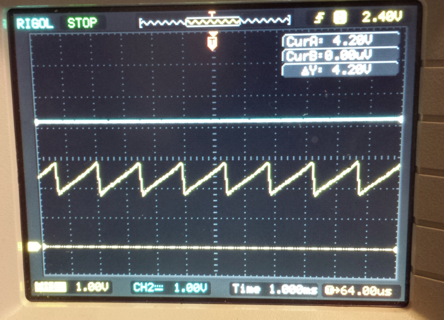

  • Jing,
    Attached are the scope shots.
    Battery is the blue trace, and OUT pins of the BQ24032A is the yellow trace. The battery is fully charge and and the voltage level reads 4.2V.
    Conditions
    ISET2 is set low, battery connected, USB connected.  I turn on the switch, and this is what I get:
    The SWITCH has not been yet toggled
    Toggling the power switch
    Notice the blue trace the battery is set at 4.2V but the part seems to oscillate.  I am not sure if it is because the 3.3V switcher tries to come up too, and given that ISET2 is low, only 100mA is being requested.  I think the part is starving.
    I expected the rest of the current to come from the battery, but it is not.  I suspect that maybe other pins need to have different conditions?
    If I solder a wire from ISET2 to VBUS, I get this before I turn on the switch to the load.  This doesn't make sense to me because the maximum voltage I expect is 4.4V regulated at OUT pins.  It is larger than the battery voltage 4.88V.
    ISET2 Pulled up to VBUS, and battery connected.  I turn on the switch to the load, and you can see the yellow trace drooping.  then it recovers.  I don't know if the battery took over, but the voltage supervisor doesn't reset my processor, and it turns ON.
    IF ISET2 is low, it won't even start and oscillates.
    I hope you can help me figure this out.  I am spinning the board, and ISET2 is now set to a pull up at 3.3V rather than VBUS.  I am not sure if this is normal operation or what, but something doesn't seem correct.
    Rob
  • Hello Rob,
    The battery voltage seems stay at the same level even when it is loaded. It doesnot look like the battery is outputing current. What happens if you connect the load to output with battery connected and input removed. What is the output voltage at this time? Does the battery voltage start to fall? I want to check if the battery FET Q2 is damaged.
    -Jing

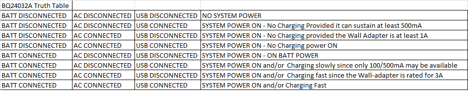

  • Jing,
    Here are my expected truth table how this device should operate.
    can you confirm this truth table is correct?  I will perform these test today.
    Rob

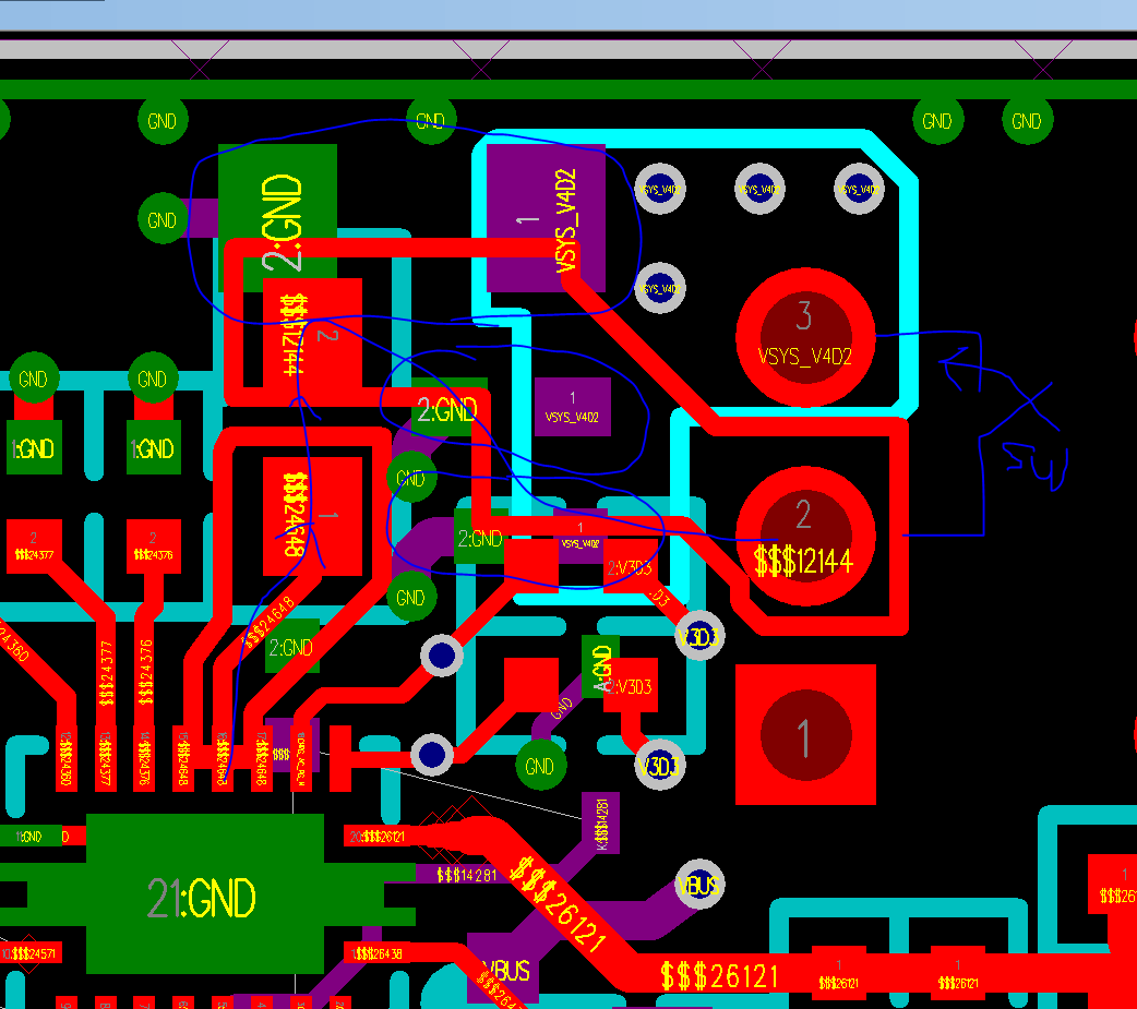

  • Here is a picture of my board.  Not that it will help you or anything, but I wanted to show you the chip is properly seated on the board.  I use a wire at R80 (see my schematic in previous posting) which is a pull-down to ISET2, if ISET2 is set low, and USB connected, OUT oscillates even if the battery is connected.  The battery doesn't source the power needed to the load that is required to compliment the USB low power.
    It feels there is a subtle event going on.  I need to escalate this case and I need help getting to the bottom of it.

    If you please refer to my schematic the idea was that  if USB or AC power was connected to the unit, Diode pair D7 could logically OR the voltage/currents, so that R69 and D9 create at 3.3V reference to CE from either USB or AC power.  I don't think this circuit is a problem.  It is possible that D10 may be causing problems, so what I will do is remove D10 so CE gets a full 3.3V.
    What is the status of your PSEL and CE pins?
    In my case D9 would pull it up PSEL through a 100K (or 10K)  to 3.3V, also I see 2.7V at the BQ PSEL pin or the other side of R80  (i.e., on side of R80 is 3.3 the other is 2.7V).  I also made my microcontroller GPIO connected to PSEL an input to provide High impedance to PSEL input, and I observe 2.7V  That would say 60uA is being pulled through PSEL.  I expect 1 to 10uA.   Is this NORMAL?
    I didn't expect the PSEL pin loading the reference much.
    Another change I will make is to make the GPIO MCU pin connected to ISET2 (net CHG_100MAL_500MAH) an input.  I wonder if when the micro comes up causes issues at the pins.  I will make them inputs and try again.
    In your setup you don't have a micro controller involved messing with the PSEL, and ISET2, so I suspect when I throw the switch ON, the Micro is setting up all its GPIO, something along the way causes imbalance on the BQ and messes it up.
    I will run some more tests.
    What should be the recommended ISET2 State (Low or High) before connecting USB to it?
    What is the recommended CE status before Power is applied to the Unit.  The voltage reference I created doesn't have much delay so 3.3V will almost reached at the same ramp rate as the PIN.  I don't believe there is a racing condition there.

    Another question, how far away are the capacitors on the other side of the FET from the IC OUT pin.  Have you tried adding local bypass capacitance close to IC OUT and GND pins?

    I got your email in time.  No problem.  If you please refer to my schematic, R79 = 0 ohms,  then SW2.  The switch is rated for 3A and so contact resistance is small.  The capacitors are about 250 mils away from the actual out pin.  I have about 57.1uF at that output, so that should be plenty bypassing at 250mils away.
    The picture below shows the out pins are routed in a shape to reduce inductance, and then it goes through R79 an 0805 0 ohms jumper which will be used to measure current later.  Then it goes to pin 2 of the switch, to pin 3 where the capacitors are located there.  Total distance is about 250 mils diagonal and about 350 mils Manhattan length.
    Again this is bizzare.  I wouldn't mind sending you a board and battery.  It just needs a standard 5.5mm jack wall wart or bench supply and you will see the issue.
