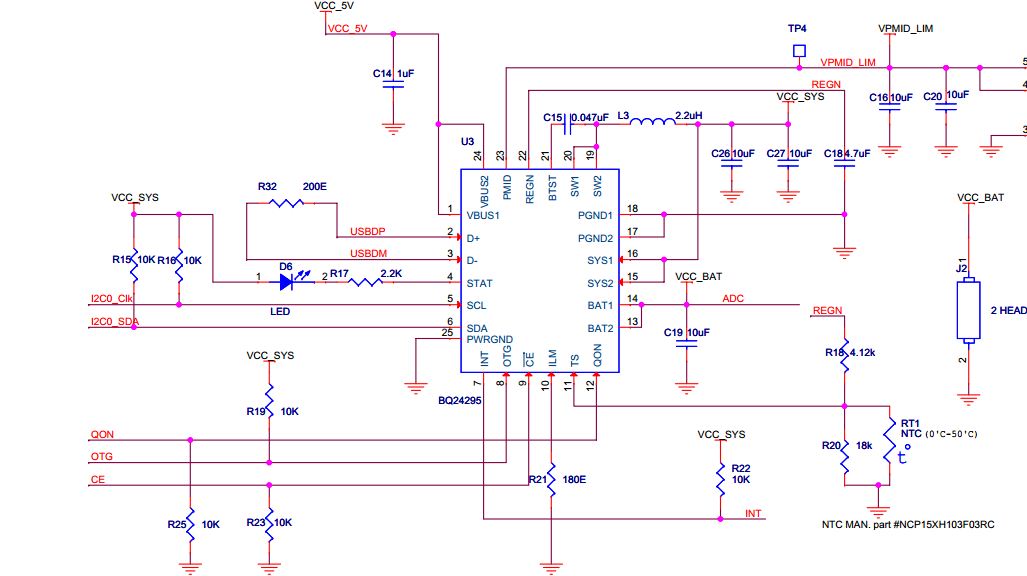

I have developed my own board using BQ24295,  but i got some trouble while running.
1) I could not read register except for REG09 and REG0A on I2C. For all other register i am getting 0XFF .My I2C code for reading register is as per follow.
start bit,salve address in write mode,ACK, register address, ACK , start bit, slave address in read mode, ACK, data@register address, NACK, Stop bit
Please let me know if there any step missing in the above sequence .
2) Boost mode is not working properly even-though all pin are set as per datasheet.

  • Hi Rachel,
    Thank you for your response,
    Yes i understood why i couldn't communicate with the device using I2C. Now It  is working properly.
    but still i couldn't  get boost converter output properly .On PMID pin i  am getting only 3.15V without any load while according  to default condition it should be 5.126V.
    My schematic diagram is the same as given in EVM.
    Please suggest  me any solution .

  • Hi Rachel,
    I have changed my PCB designed and i got boost converter output 5.2V. But OUTPUT on PMID pin is stay stable for some time and when load of 500mA  is connected it decreased(3.5V).
    Status of REG08 is 0x00 and REG09 is 0x80 and mentioned conditions required for boost operations are satisfied perfectly.
    My schematic is same as given in EVM but PCB is of 2 layer and 3.3V for controller is generated by LDO.
     Regrds,
    Hardik

    REG09 = 0x80 is Watchdog timer expired which will reset the register values.  Please disable the watchdog for testing purposes, or be sure to maintain proper device communication to prevent timeout.
    A 4-layer PCB is recommended for best OTG load regulation, but it is possible to use a 2-layer solution if special care is taken in the layout and board stack-up.  Please reference the bq24295 2-layer EVM user guide for layout and stack up recommendations as well as test results:  http://www.ti.com/lit/ug/sluuao5b/sluuao5b.pdf
    In particular page 2, Figure 1 has a detailed chart showing the effect of different layouts and stack-ups on OTG load regulation.
