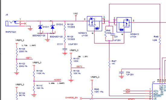

We are using the BQ24610, and are using a design based on the reference design in the data sheet, after choosing our currents and voltages and such.
We are having two problems:
1) The BQ can detect when the charger is plugged in and will assert STAT1 appropriately.  It however will not detect that the AC has been removed.  When we look at the gave voltage of the ACFET combination, it drops the better part of 6 V, but not the full 6V the datasheet says.  We are using the 100K across the G/S with the recommended capacitor, with a 1K to the ACDRV pin on the part.  It seems in capable of shutting the FET off, like it is latching up.  The part seems to think it is charging the battery from the battery (STAT1 stays asserted). If we then ground the gate of ACFET momentarily, then it shuts off as expected.

  • Hi Colin,
    1) Could you share the schematic that illustrates the connections you described for this problem in your post? Are you using the TI EVM for this device or have you created a PCB for evaluating this device? The ACDRV pin is designed to drive P-channel MOSFETs, but what you are describing sounds more like N-channel MOSFETs tied to the ACDRV pin.

  • 1) Please see attached.  We are using P-channel mosfets (AON6413), back to back in the same configuration as in the reference design.  There is also a 10K resistor from VAC to GND which is not shown, which doesn't seem to be draining it the voltage at the jack when we pull it out.  We created out own PCB, on a larger form factor for ease of layout and testing, than the final target board.  If we regulate the voltage down with a bench supply, then it does shut off, but not if we just pull the plug.

  • 1) What is your nominal VAC voltage? When you pull the plug, what is the voltage on VAC and VCC? VCC must be below 4.1V (typical value) before the IC sees this as an UVLO event. ACDRV and BATFET are disengaged when VCC <= 4.1V. So from this, it sounds like the UVLO threshold is not being reached, which is why the ACFETs are still conducting.

  • Thanks for your response.  I was pulled away to work on another project and didn't get back to this until now.
    1) We are supplying 18-20 Volts.  Pack voltage fully charged is a nominal 16.8 with 4 cells. This problem of not detecting absence of VAC seems to have gone away during the two months it sat on my bench.  I'll keep an eye for it repeating.
