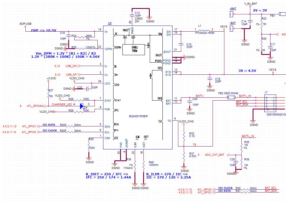

As I know, TI BQ24251 is fully BC1.2 compatible parts.
But when verify USB eye pattern then got fail report at Battery full.
Please kindly provide the verify method or relate verify report for our reference.

For the eye pattern test, can you suggest the customer add isolation resistors between the USB lines and our D+/D- pins? A few ohms will do.
BTW, the ILIM and ISET calculation doesn't seem correct to me. The KISET is 250 and KILIM is 270, so based on the resistor value in the schematic:
IFC = 250/120 = 2.08A
ILIM = 270/174 = 1.55A.
