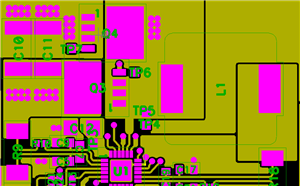

    “A low-ESR ceramic capacitor such as X7R or X5R is preferred for the input decoupling capacitor and should be placed as close as possible to the drain of the high-side MOSFET and source of the low-side MOSFET.”
    What we still find confusing is the indefinite article “A” suggest there is only one (or one set) of such capacitor, yet it should be placed both close to (drain of high MOSFET) and (source of low MOSFET). Does it actually mean: C8’s positive near Q4(high MOS)’s drain, and C8’s negative near Q5(low MOS)’s source?
    In addition, could the Gerber file of HPA422 be added to the EVM’s page, or forum?
    Hui
  • Hui,
