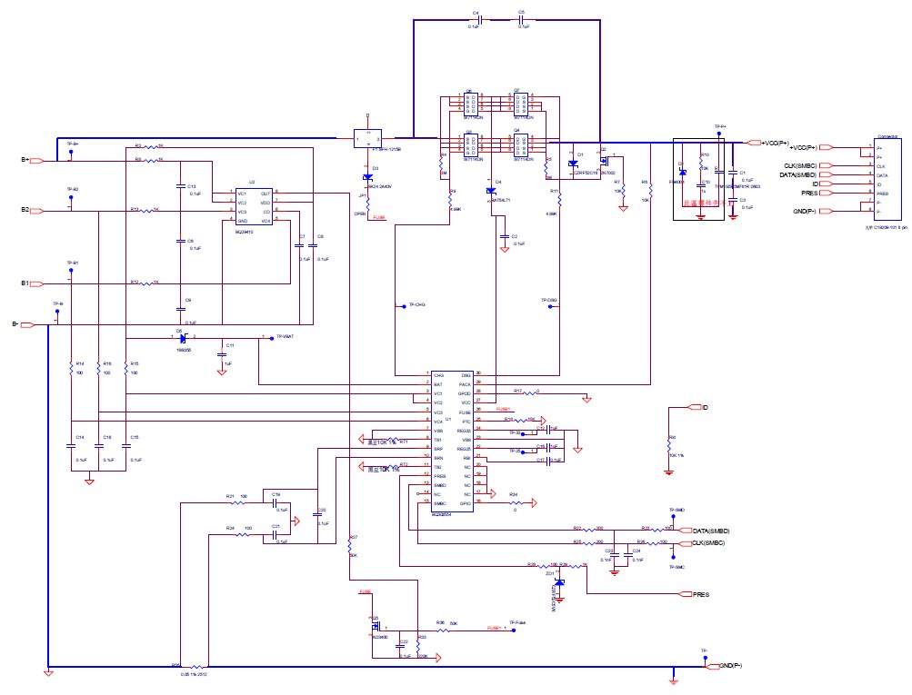

I designed a battery charger for a 3S2P Li-Ion battery pack. The battery charges correctly from 4% to 100% but at the end of the charge, STAT1 starts to blink and STAT2 never turns on.
Could you please help ?
I have attached my schematic.
DC_IN= 19V
ID =GND when battery is plugged.
Measured charge current (fast charge)=2.04 A
Measured charge voltage (fast charge)=12.6V
Thank you.

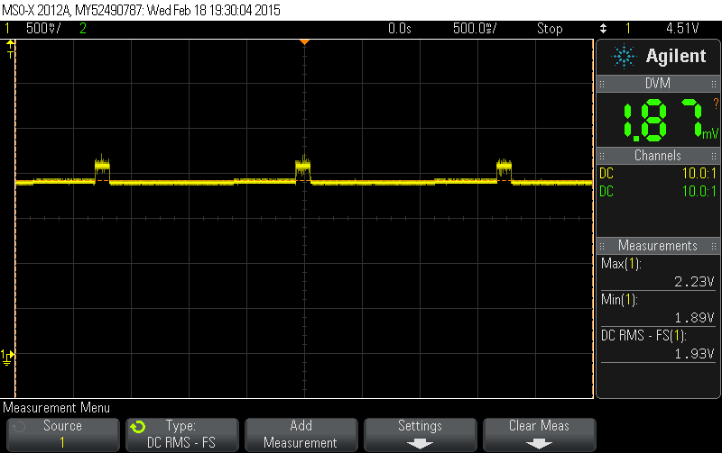

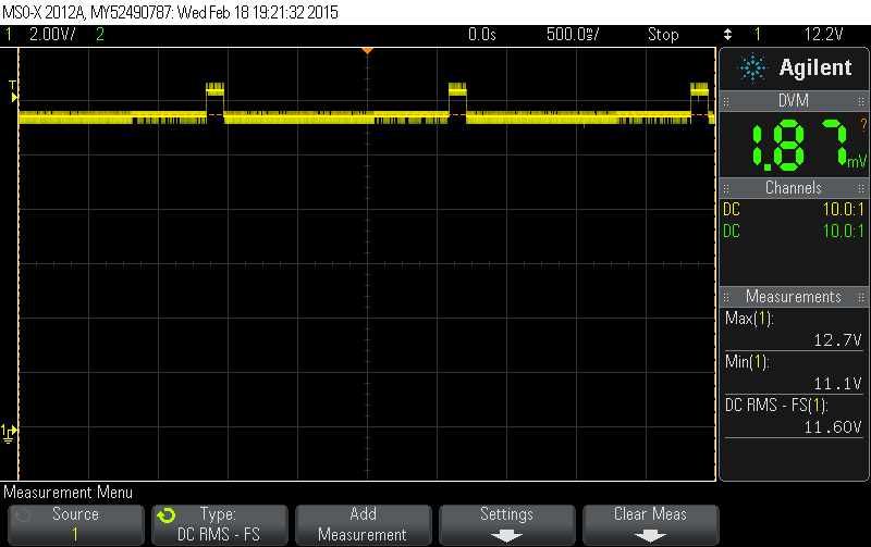

    I did attach the scope showing VBAT (PACK+ on the schematic) in yellow and VFB in green.
    This happens when the charge is complete.
    Any idea on what could make this happen ?
    Thank you.
    after more investigations, it seems that the battery never reaches its full charge voltage, ie 12.3V. Charge current drops to 0 when it reaches approximately 210~200mA.
    Battery pack voltage is measured at 11.95 to 12.15V (depending on the battery pack). This makes VFB falls and the charger try to restart the charge cycle. I think that's whay STAT1 blinks.

  • This phenomenon is the battery detection scheme (see figure 19 on page 22 of the datasheet) that is triggered during power on reset or when recharge is triggered (Vfb < Vrech). It looks like the the battery detection scheme passes the first test which is to sink 8mA from the battery for 1s and check to see that Vfb is not lower than Vlowv (which is 1.55V on FB pin). Because this test passes, the charger starts charging the battery, and the battery voltage immediately jumps up to ~12.6V (estimating from the scope capture). When it reaches 12.6V, the charger stops charging the battery. However, it looks like as soon as the charger stops charging the battery, the battery voltage drops (>50mV drop on Vfb) causing the charger to go into a new recharge cycle. This indicates that the battery pack is not allowed to charge, but discharge is allowed (since the charger is able to draw 8mA from the battery during the battery detection scheme).

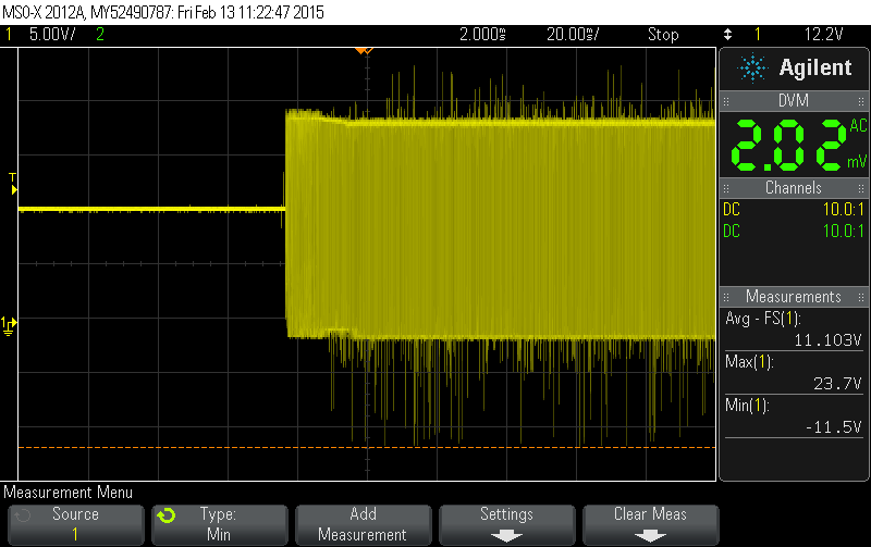

    Could you capture the waveform at the PH node? It should start switching as soon a battery is detected. Also, do you have the charge voltage and current profile of the battery pack as it nears 12.6V?
  • VRECH threshold is a fixed value for a given charge voltage target set by the resistor divider on the FB pin. It is indicated by FB pin voltage dropping by 50mV.

    Here is the scope of PH when battery starts to charge:
    During fast charge voltage phase, I can see the battery current drops from ~1.95A to ~200mA then falls to 0.
    At the end of charge, battery voltage is between 11.95 and 12.15V.
    This voltage seems to be normal as the BQ30z554 inside my battery pack will close the 2x charging MOS when the battery is fully charged (ie 12.4V on the BQ30z554). When the 2x charging MOS are closed, the voltage will decline about 0.3~0.5V because body diodes are on.

    Please find here my battery pack protection circuit schematic

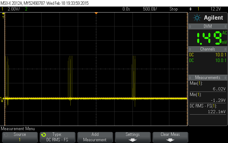

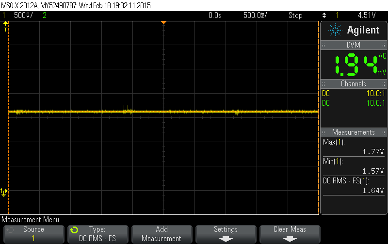

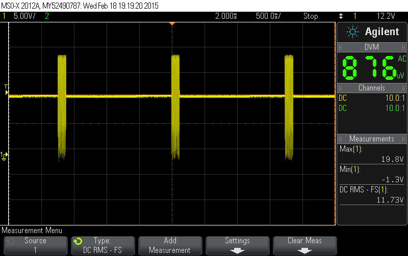

    These are different scopes when the charge is complete but STAT1 is flashing.
    VFB:
    SRN:
    PH:
    REGN:
    LODRV:
