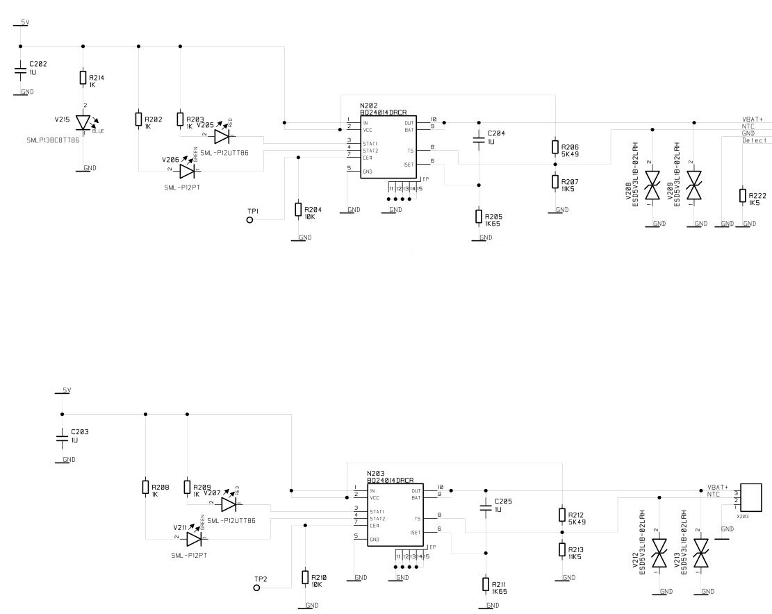

in our design we have 2 BQ24014 chargers on the same pcb. Interestingly connecting a battery to one of them will kick the other one in a weird state where:
BAT goes up to 5V (Vcc), and STAT1 will start short blinking (like on POR) every 570ms. (I suspect that's the sleep mode deglitch).
When we connect even for a short time a battery to this second charging chip the blinking will stop, but there is a good chance that connecting battery to the first one will restart it. The Vcc drops to around 4.5-4.7V when the first one gets a battery connected.
Is there anything we could try to eliminate this problem? What triggers this endless loop or resets? Also sometimes upon removing the battery from the first one will leave that in this exact same blinking state as well.
Thank you
