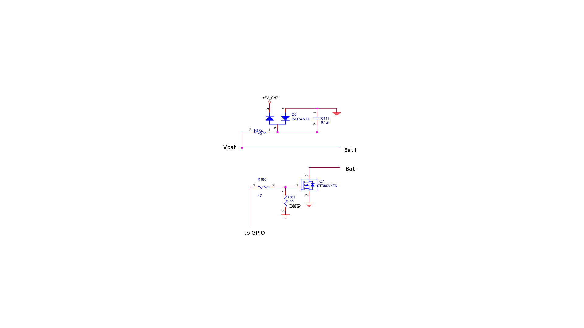

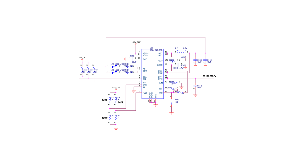

I'm on a project with bq24192, but i'm facing a problem about charge current with it.
If i set fast charge current limit less than 1600mA, bq24192 charged at this value, but when i set the current >= 1600mA. charged current is only 600mA.
And when i power up this chip, not sent any commands to control it, follow the user manual charge current will be 2048mA, but when i measured, the charge current was about 400mA-600mA.
