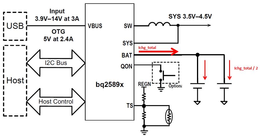

bq25890 / Charge 1s2p Li-Ion battery
Other Parts Discussed in Thread: BQ25890
My customer is looking for the solution to charge 1s2p Li-Ion battery. I'd like to suggest bq25890 but then I think we need to care about cell inbalance or impedance mismatch. I know we can charge 1s2p battery as attached if the spec of each battery is ideal. Can you give advice if we need to add additional circuit to charge 1s2p battery with standard 1cell charger?
