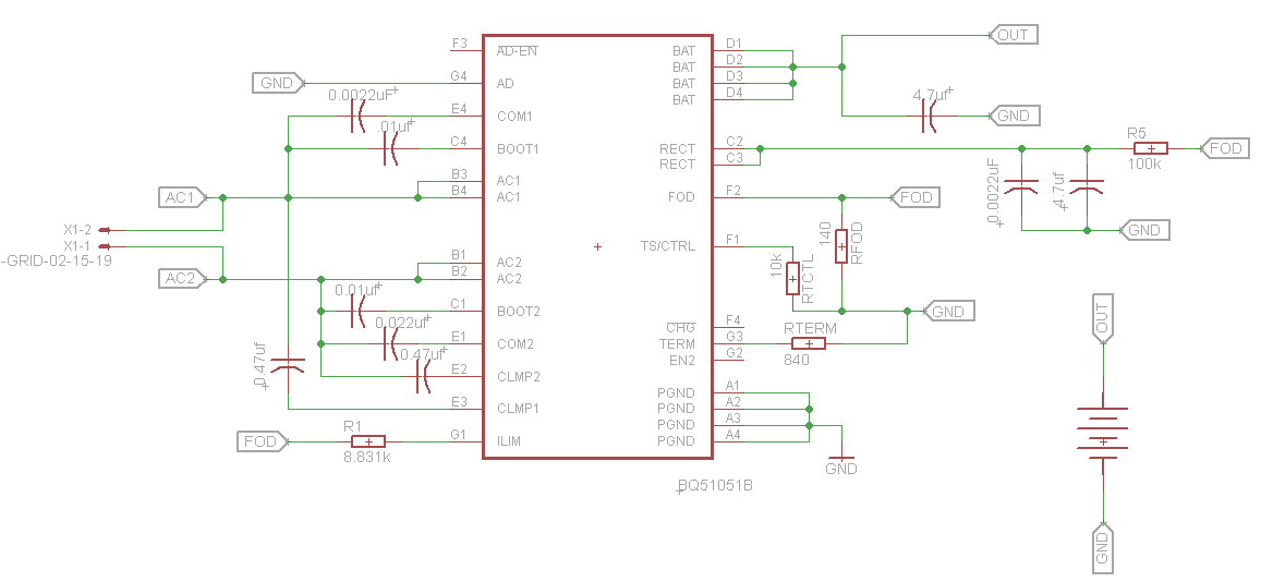

    Can you please verify my design for charging 35mA battery at 4.2V using BQ51051B.
    Kim
  • Kim,
    The capacitor on COM1 shows 0.0022uF and it should be 0.022uF (as in COM2).
    Charge Current is set to 35mA as you desired.
    Termination current is set to 3.5% of charger current, or 1.2mA. Please see the "Termination Calculations" section for other options.
    As noted in previous posts, this solution will not be consistent over a large build.  Charge current and termination current will vary.
    Also, the bq51050B has a regulation voltage of 4.2V while the bq51051B has a regulation voltage of 4.35V.
    Dick
