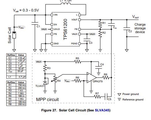

  • I should also say the solar is using the TI reference design with a TPS61200 and the additional MPP tracking circuit

    Yes, its only a 4w panel, so max current @5v ~800ma at full sun, which it rarely will see. Its always connected and the plan is to keep the system alive by harvesting energy whenever the sun comes up. Here is the example I based the attempt on, but I used a higher current device..
    I have R1 calc'd to keep the voltage below the 5v USB so when you plug in the USB, it will select that source. We were trying to keep it simplet.

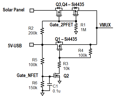

  • That didn't post quite right. Here's the solar diagram I used.
  •  When both the USB and solar panel are connected, if you want to get any power from the panel, the voltage at the output of the TPS61200 needs to be set higher than the USB voltage.  The max output current you will get from the panel through the TPS61200 can be estimated using a power balance:  efficiency = Vo/Io / (Vmpp*Ipanel).  To minimize losses through diodes, I recommend the attached circuit or something similar instead of diodes to create the MUX. I also recommend that you dynamically change the input current limit and/or use the charger's ICO feature to optimize the input current limit, especially when only the solar panel is connected.  You will also need to manually change the VINDPM threshold.

  • I was applying the circuit today and noticed that there wasn't a part number called out for the GAte_NFET. I don't want to screw up again and wonder if you can recommend a part number?
    Thanks! John
  • the NFET can be any low cost NFET with Vth <=3.0V. 2N7000 should work.
