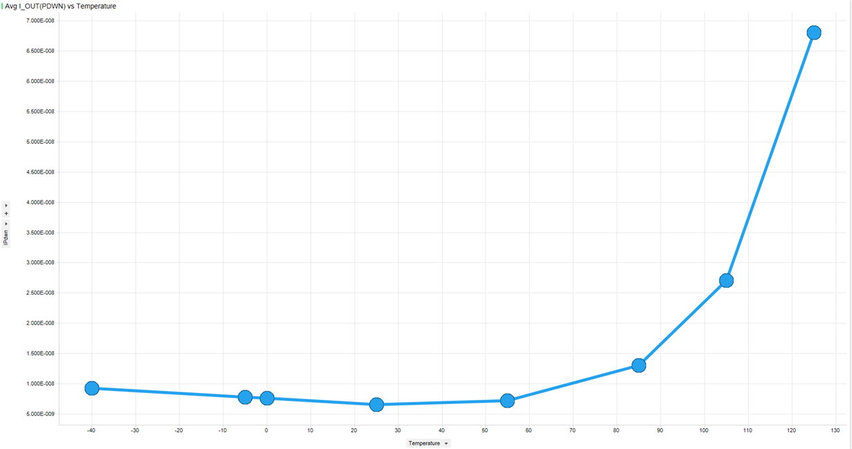

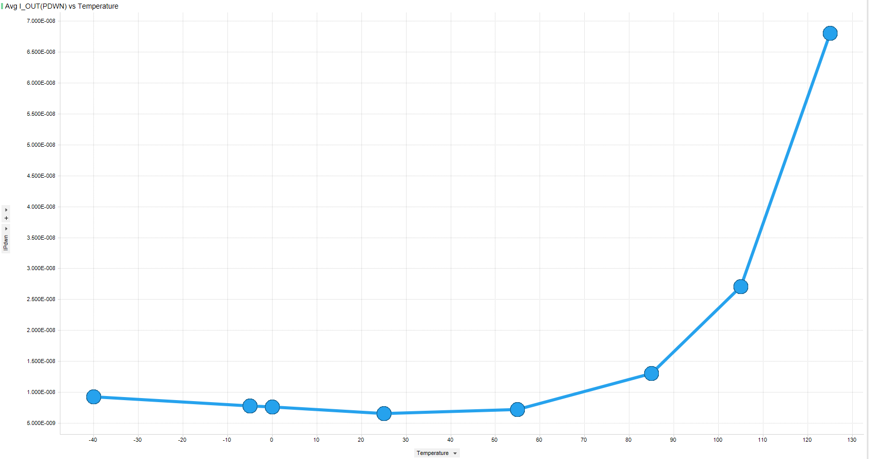

  • Hiro-san,
    Please see the plot below.
  • Hello Jing-san,
    Thank you very much for sending this graph, and it looks good for the customer because they are going to select a low Iq device.
    I'll deliver it to the customer.

  • Hello Jing-san,
    I got feedback from our customer, please check below.
    Please let us know the conditions of the graph. It seems VIN is 0V, and what is VBAT value ?

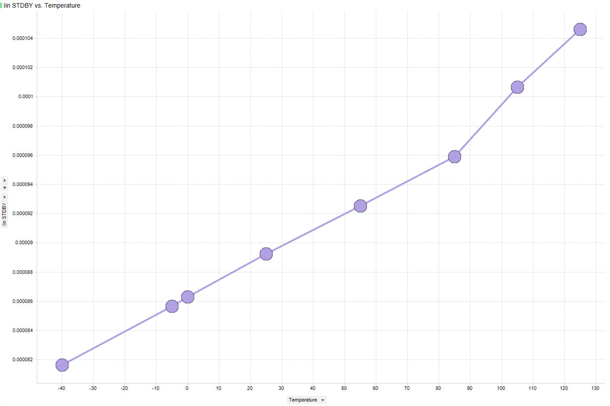

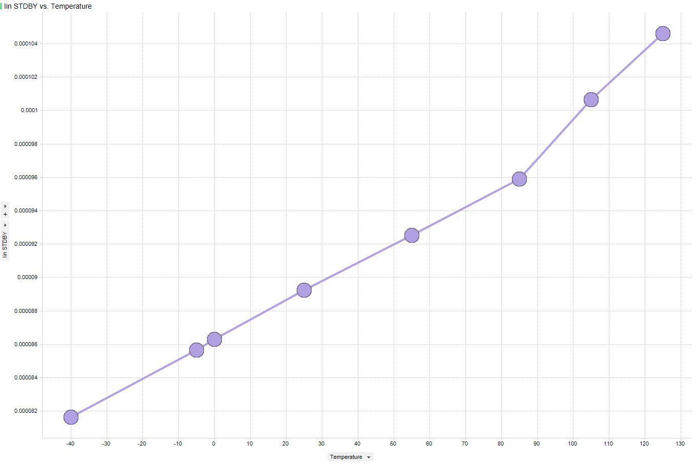

  • VBAT is at 4.2V for IOUT(PDWN)
    Please see the below plot for IIN(STDBY) over temperature. VIN is 6V.
  • Hello Jing-san,
    Thank you for your sending the graph, this is very helpful for the customer.
