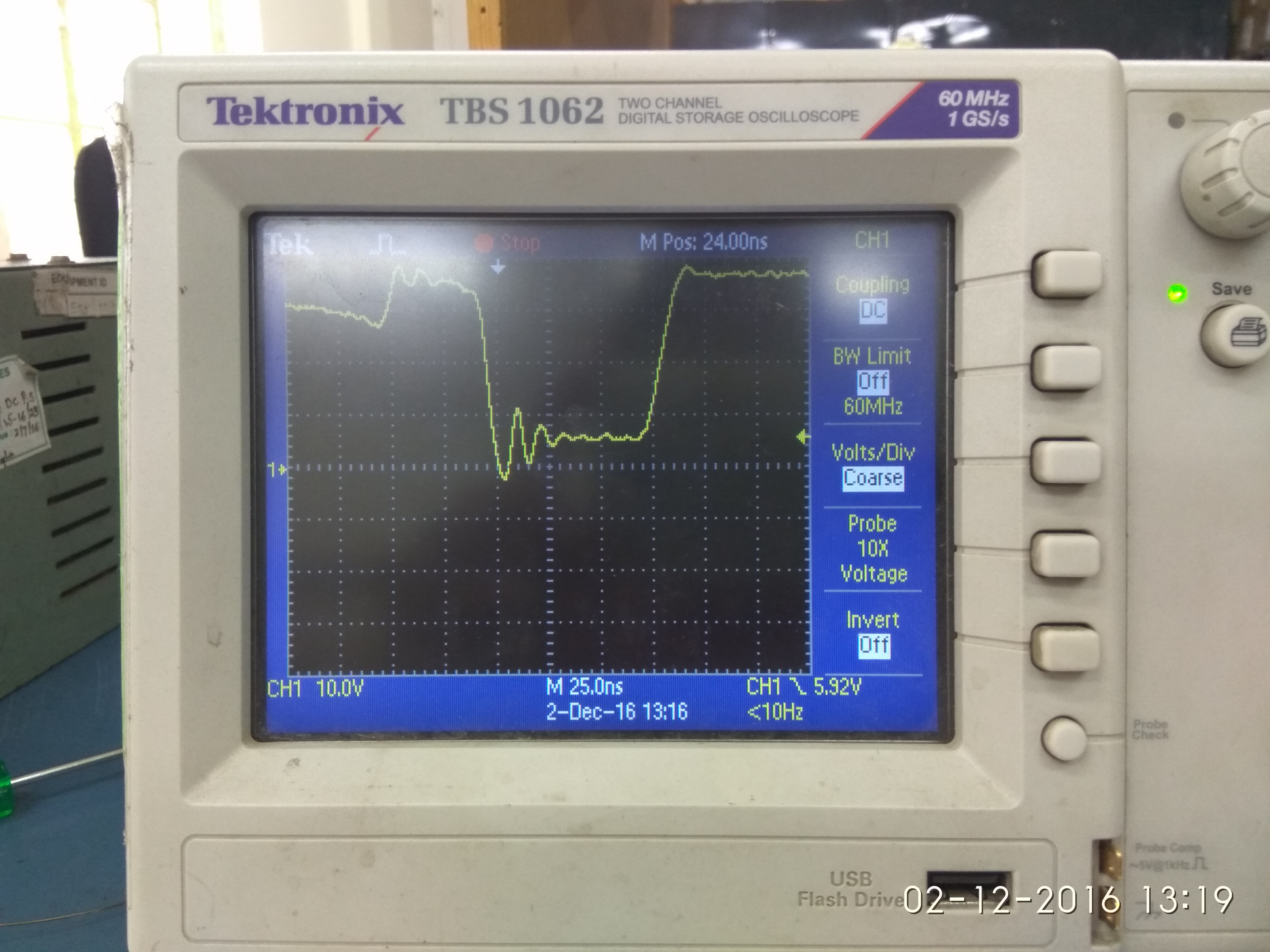

I would like to know whether bq24600 can be used to charge  6 cells Li-Ion battery of 7.83Ah capacity with 3A charge current or not. I'm using the same circuit mentioned in its datasheet with suitable calculations for 6 cells Li-Ion battery and 3A charge current. The charger circuit is sourced from 28V/3A regulated power supply. But the charger circuit consuming only 130mA from the source. The voltage across battery does not increased  for 2 hours also. please suggest me the suitable application circuit or any changes to be taken. Here I'm attaching the schematic I have used.BATTERY CHARGING SCHEMATIC - 161109.pdf

    The inductor plays a role in the small signal modeling of the converter, and would mostly play a role in the load response/stability of the circuit. Could you show me the waveform of the voltage across SRP-SRN?
    Other helpful waveforms would include: SW, VBAT, IBAT(if possible), and Vfb. Have you tested to see if the charge profile as a whole still wokrs? I would look for precharge, fast charge, and termination.... is the output voltage noisy?
    Also, would you mind sharing your layout with me if possible? I have found that many questions similar to yours have been layout related.
    we could not capture the required screen shots of scope as the Q2 FEt got damaged a few times. And the voltage across C5 capacitor drop at certain events we can't identify the reason. Even if the battery is not getting charged the STAT led is still glowing. We can't find the reasons behind this strange behaviour of IC.

    As far as what could damage Q2 - my guess is an overvoltage or overcurrent condition. If you have a lot of ringing at the switch node, that votlage can couple through the gate and turn on Q2, creating a short from Vin-GND.
    Are you switching the relay circuit at all while charging? If you are dumping charge current into the battery, then take away that connection there will be significant ringing. Can you remove that part of the circuit, and try to only charge the battery? I am guessing you are using the V+ V- connections from the relay to power your system. Removing that will help us narrow things down.
    I have removed the relay and the output of charging circuit is directly shorted to J1 connector in our board. We have placed the c10, c11 capacitors close to the IC and the output is somewhat better. The battery is charging with 3A with the VCC of 25.6V. But when we increase the VCC more than 25.6V, the charging current decreases rapidly less than 1A. Could you please send the gerber files of bq24600 EVM? I would like to know the working of the bq24600 IC to charge the battery.

    All filtering caps should be as close to the IC as possible. From an electrical standpoint, they are on the correct node. Physically, noise can still couple into that node if the caps are far away.
    It sounds like you may have a pretty noisy board. If you have a large amount of ringing, you could be causing the charger to jump into and out of ACOV, causing the effective charging rate to be less. It could also be coupling into SRP/SRN, which will either directly effect charge current, or could cause cycle by cycle overcurrent protection.

    If you can place the ground of the output capacitors closer to the ground of the low side switching Fet, I think you will see some improvement. The will redirect the large di/dt loop away from the analog ground of the IC.
    If you want to try and run a small batch with the current layout, it will probably be functional. I have only seen a couple cases where the interference was actually bad enough to cause problems.
