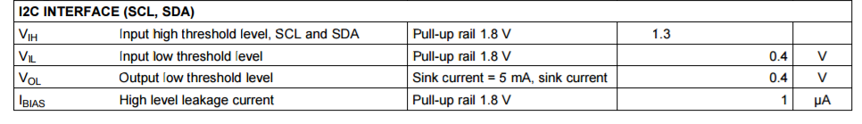

Hello team ,
My customer VVDN wants to know what shall be Vih and Vil for the SDA and SCL lines when the pull up resistances are pulled up to 3.3V
The datasheet specifies the Vih and Vil for 1.8V as shown below
Thank you so much

Hello Shreenidhi,
The VIH and VIL thresholds are defined on the I2C specification. On the latest revision of the spec, the thresholds are defined as follows:
Using a VDD of 3.3V means the VIL and VIH thresholds would be 1V and 2.3V respectively.
Please ensure the pull-up resistor is also chosen to account for the bus capacitance and rise times required for proper communication.
