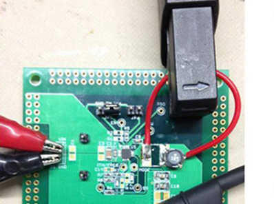

    I tested with TI's evaluation board called " BQ24133EVM-715-5V ".
    And I found the charging status is different as per input voltage level.
    1. Vin : 8.9V
    -> when the battery voltage is up to 8.1V, then continue charging with under 50mA.
    2. Vin : 9.1V
    -> charging normally complete at 8.4V. Just after finished charging, the detached battery's voltage is over 8.35V.
    I wonder the reason why the charging status is different due to input voltage.

    The reason you are seeing the changes between input voltages is because of duty cycle limitations. When you are near 95% duty cycle, the bq24133 starts to pulse skip and loses regulation. You need to maintain input voltage higher than 95% duty cycle from max battery voltage so that you don't lose regulation. Your input voltage must be higher than VBAT/.95 + IR drop.

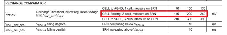

    2. Recharge when the battery charges to full then VBAT drops to about 8.2V(Consider the error, please try to discharge the battery to 8V), BQ24133 will start to re-charge.
    -> for this, I attached a table from the BQ24133 datasheet. You mean I can refer to the table? As for my test result, the recharge work at 8.31~8.32V.
    The purpose of this question is to prevent the frequent recharge when the customer use the terminal with connecting the charger.
    --> Which table?  How about you battery's internal resistance? Can you provide your battery's technical document.

    2. --> Which table?  How about you battery's internal resistance? Can you provide your battery's technical document.
    you can find the table from datasheet at previous thread ( Mar 15, 2017 6:23 AM ),but I re-attached as below.

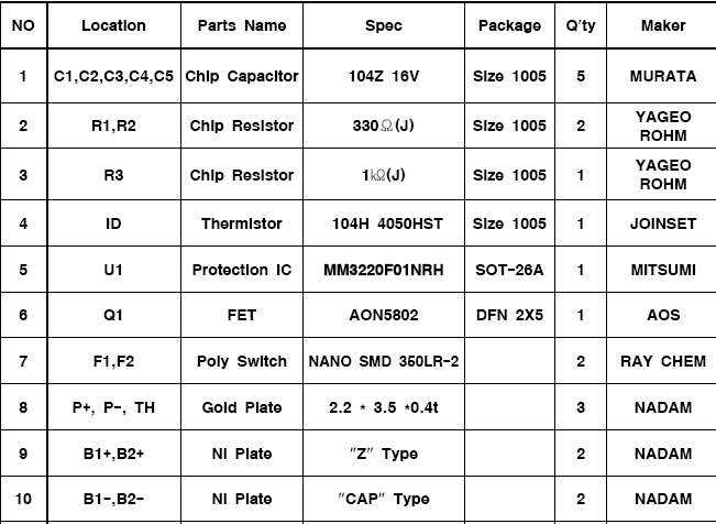

    and also below is PCM circuit and PCM Part list.

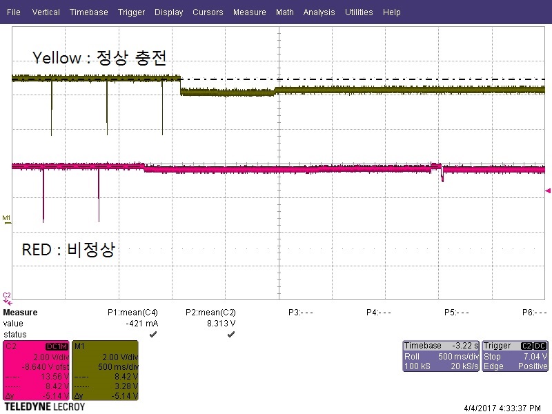

    Below waveform is from charging as 110mA. (Current Probe).
    I can see below waveform when the chaging current is low.
    charging voltage is 8.347V.
    TS

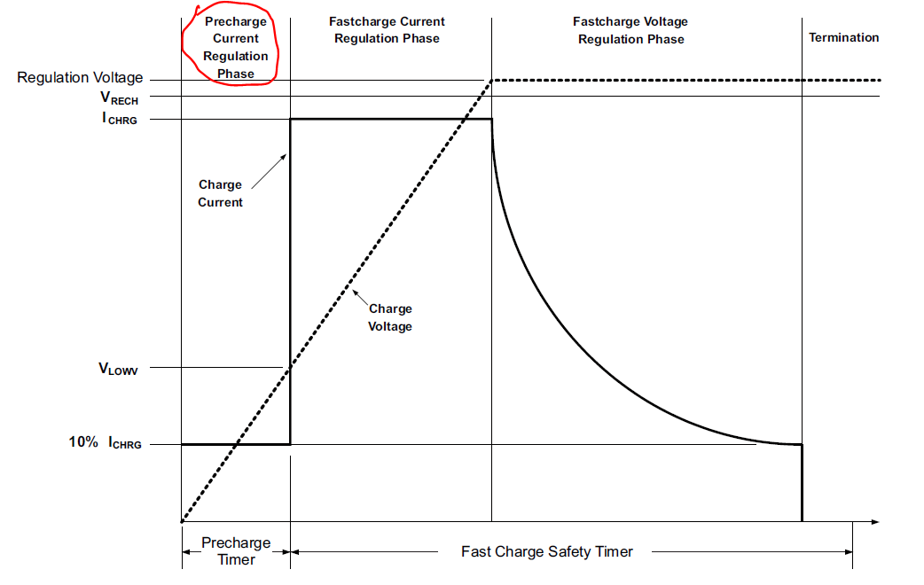

  • Hi TS,
    3.1  Please refer the charge profile below
    I can't see the time scale in the picture, can you upload a high resolution one?
    Alen Chen
    -> I already found that chart. However, my question is the explanation for numerical factor of Pre charge time (of timer) and fast charge timer function of action.
    According to my test, when charging the fully-discharged battery, there is almost no pre charge time and just switch over the cc mode.
    I'd like to know the independent 30mins safety timer of pre charge and also other functions of pre charge.
    3. please review below original waveforms.
    <CV mode current>
    <NO9-CHARGE (BAT AHN2)>

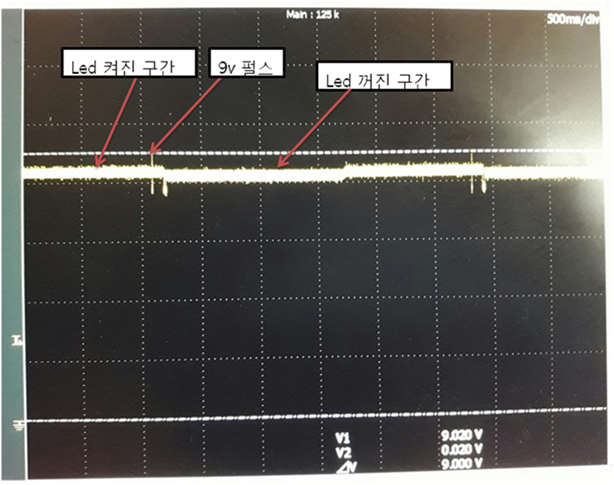

    Below waveform is from the battery manufacturer.
    (I had problem for charging, so requested analysis to battery manufacturer and got below waveform from them.)
    As below waveform, when connect the battery to charger, 9V overshoot occurs and battery PCM module shut off the charging. And repeat same operation continuously.
    (battery charge status is under 50%).
    Can I ask which one is the root cause, battery or charger ?

    3.1 Generally, the time of pre-charge is very short because of the capacitance on Vbat<3V is very small and meanwhile the internal resistance of the battery is big , If you want test pre-charge you need to clamp VBAT lower 3V/ per Cell. You can use electronic load to clamp VBAT.
    3. Please plot IL(inductor current), PVCC, VBAT, ICHG. Can you provide the schematic and Layout?
    4. I can't judge, can you please try to test other battery pack?
    -> I understood. Thanks.
    -> I attached final schematic as below.
    -> I found there's no problem with anorher battery pack. Though this is battery problem, can you explain the cause of this symptom?
    -> How should IL measure be taken?
    -> ICHG means, do you want charging current?

    -> Below is the waveform that compare the normal charge(Yellow) and abnormal one(Red).
    [Alen]: please refer to the picture below
    Yes, Charging current
    --> As you provide information above, I think it would be the OVP voltage of the protector is too low. please try to adjust the voltage threshold. You also can discharge the battery to about  7V than try again.
