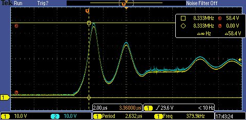

  • Hi Alen,
    Further testing has revealed that the following.
    With no UUT connected to the cable and switch assembly, a 'scope trace shows that when the switch is thrown, the battery supply overshoots up to 31V before settling to its static supply of 22.4V.

  • Hi Alen,
    Yes the 4S LiPo pack at 16.8V did not cause a failure with the switch assembly, but the 6S does.
    UUT is the 'unit under test' which means the whole PCB assembly was disconnected from the switch and battery assembly.
    The UUT now has Q4 and the bq24616 removed for safety, until the waveforms below are within the design parameters.
    Here the SRN (yellow) and SRP (blue) overshoot. SRP measures 33.^v
    This trace is taken with a 3R9 resistor in series with C20 10nF 50V to create a snubber across SRN and PGND. C23, C25 and C27 have been removed.
    this is worse but reduces the ringing. C17 was removed at this point and C21 (100nF fitted)
    One further concern is that in all traces, the voltage drop across R18 (10mR 500mW) is 2V. That is a lot of current. L1 is a 3u3H shielded SM inductor with a resistance of 17.7mR in accordance with the design specification.

  • HI Geoff,
    Thanks for the waveform. It looks a over voltage problem.  Please don't remove output capacitor when you add the snubber. Waiting for the test with TVS.
    For R18, please check CH1 and CH2 on your scope is matched or not.  You also can consult to the resister vender.

  • Hi Alen,
    I am still having issues with the bq24616 having added an SMBJ16 TVS diode (clamping at 26V) from the R18/SRN junction to PGND plus I have added a snubber circuit to the same point.
    The battery lead has now been shortened to 100mm with no switch. The battery was connected successfully three times but on the fourth, the bq24616 cracked and smoked in the area of pins 19, 20 and 21. Q4 D-S measured 69R.
    I experimented with the snubber circuit and derived the values from established equations.
    The traces of SRN and SRP are here: The overshoot is within tolerance of the bq24616 suggesting the TVS and or the snubber are suppressing the ringing compared to the previous post.

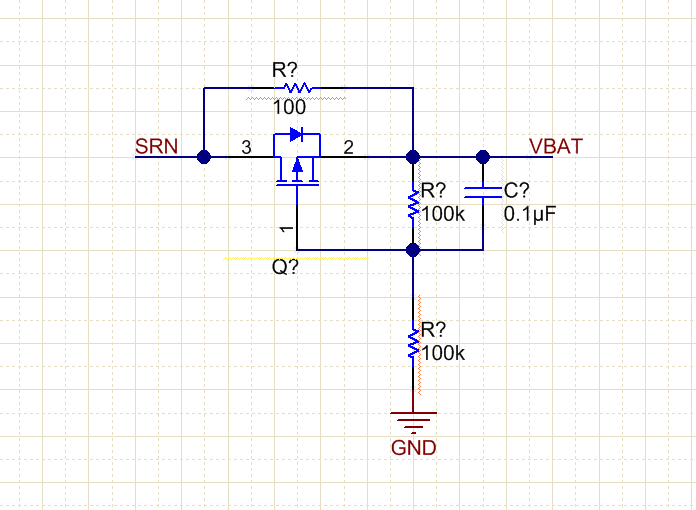

  • Hi Geoff,
    If the TVS and the snnuber still can't solved the problem,  Please try to use a PFET between battery caps and battery connector  to reduce the inrush current and overshot.  Please refer to below circuit, You can modify the values to modify the time of tun on. hope it helps
    Thnaks.
    Alen Chen

  • Hi Geoff,
    You are right, thanks for you feed back. pre-charge the capacitors is very helpful. But this may need a special connector which connect battery and charger through a resistor first, than connect battery and charger directly.  So we suggest to use a PMOS (above )to implement same function.
    Alen Chen
