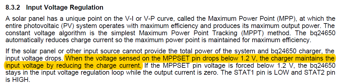

    2. Some times we got 1.2V MMPT at PIN 2 of charge controller.
    As shown in datasheet "8.3.2 Input Voltage Regulation", bq24650 will try to maintain MPPSET voltage at 1.2V.
    3. Can we put one Boost converter before charge controller? (junction at USB connector and Solar panel), so the fix 1.2V MPPT is generate.
    We need to know the V_MPP of the solar panel to set the input feedback voltage and the sensing point is connected directly at solar panel output. If we add a Boost between solar panel and charger controller, it's not real solar panel's behavior.

  • Hi Mitul Tank,
    There are some questions need to be confirmed,
    for Charging/not charging
    1.Is the "not charging condition" occurred at USB source or Solar panel source?
    for schematic review
    1. Solar panel Max Operating Voltage: 6.0 V +/- 10% --> Is that V_MPP?
    2. MPPSET need to be set according to V_MPP. If V_MPP is 6V, then you need to change MPPSET voltage divider to meet V_MPPSET=1.2V @Vin=6.
    3. why do you use D23?
    Ann Lien

  • Hi Mitul,
    For your design,
    Since the VMPP of solar panel is 6V, you can't use the same voltage divider on both USB and solar panel source. you need to add a USB detect function and use two voltage divider switching them through MOSFET. When it detects USB source plug-in, it will control MOSFET the change voltage divider for USB source.
    For the non-charging condition,
    Is there any switching between USB and solar panel or only single source @ non-charging? If it will change input source, it's maybe caused by the input regulation.

  • Hi Mitul Tank,
    I'm wondering if there is a condition like shading results in non-charging. Solar panel cannot support that much current so that bq24650 stops charging and solar panel output drops lower than USB, then it is powered by USB. Since there is a wrong design in input regulation, it won't charge the battery when you use USB as source.
    If there is still an issue after changing your design, we can discuss more detail of it. Let us know if you have any question.
