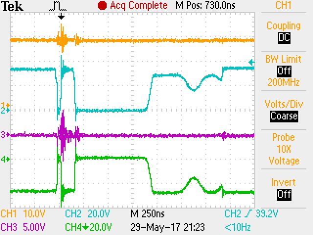

I am trying to build a 6 cell / 2A Li-Ion charger using BQ24618.
So far my prototype is charging the battery, but the n-FET (I'm using a Si7288DP dual n-FET) is getting very hot quickly (it reaches 60°C within a minute or so).
From the scope traces it seems to me that REGN is unstable and LODRV not switching properly:
Channels from top to bottom: REGN, HIDRV, LODRV, PH
Channels from top to bottom: REGN, HIDRV, LODRV, PH.
The schematic is closely based on the reference design given in the datasheet (attached below) and the PCB section of the buck converter looks like that:

    Can you check that is there any short condition, and give me your voltage information of IC's pins(like VCC, VBAT).

  • Hello
    From the waveform, it seems that the BUCK haven't be open/closed normally, you could refer to P13 in datasheet for normal switching waveform. Please check if the connection of your board's buck is right. Could you capture the waveform for several cycle in one picture, includes IL, HIDRV, PH, VCC waveform.
    You say "current sense pins measured at least several k ohm", it's not normal. the current sensor is too big, so IC will judge your current is too large, then start protection and close the charging process. please solve the issue on your board.

    Anyway here are the waveforms you requested:
    The waveform are from top to bottom: VCC, HIDRV, PH, I_BAT (channel 4's zero point is excatly at the bottom of the screen, the arrow indicator is misleading). Battery current has been measured using a 1 Ohm shunt in series with the battery's ground connection.

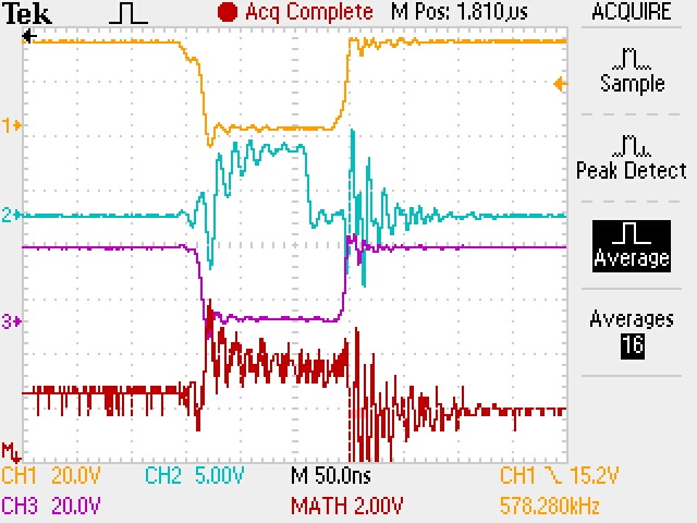

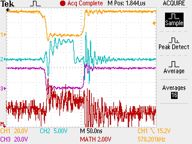

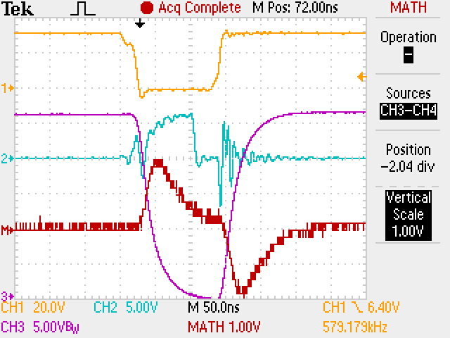

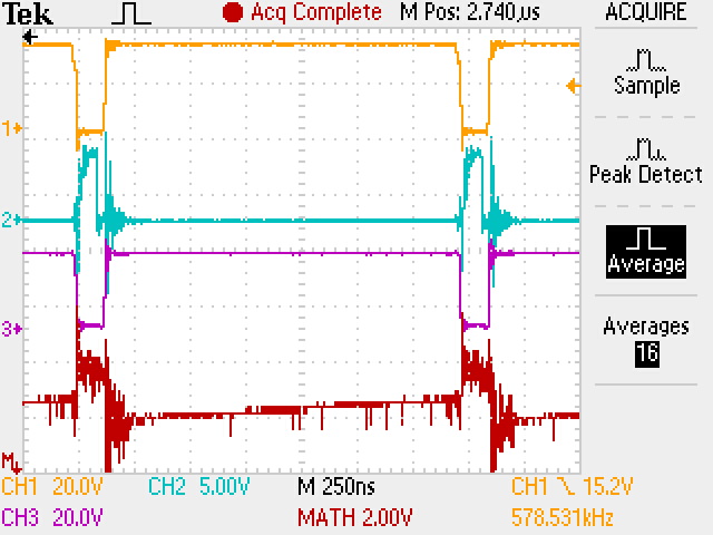

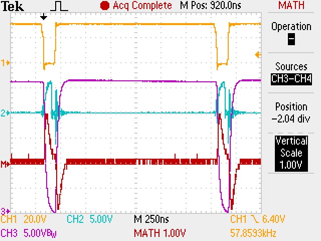

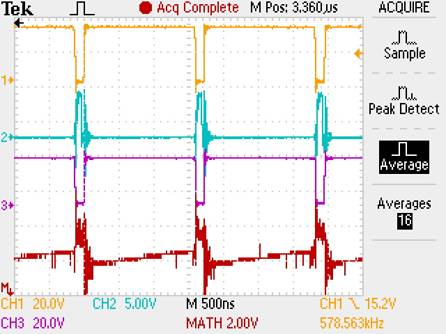

  • Here are the requested scope traces:
    CH1 is HIDRV, CH2 is LOWDRV, CH3 is PH and the math channel is inductor current.
    The inductor current is measured using a 1ohm shunt resistor between the PH and the inductor (so 1V equals ~1A). I do not have a differential probe so I had to use the math channel to substract CH4 from CH3. The result was rather noisy, so I enabled 16 sample averaging, which the scope can only do for all channels.
    Here's single pulse without averaging, for comparision:
    Jens

  • I also managed to get better plots of the inductor current today, I hope these are usable:
    Channels are the same as before: CH1 = HIDRV, CH2 = LODRV, CH3 = PH, MATH = inductor current.
    The first 2 screenshots are with averaging enabled, the last one is without averaging for comparision.
