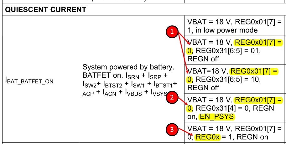

Now I'm referring test condition of quiescent current at system powered by battery, then I found some incorrect condition (typo?) as below. Can you see it and give you comment?
  1. I believe that REG0x31[6:5] is used at low power mode, so I think this condition should be low power mode, REG0x01[7]=1.
  2. This should be also low power mode, and REG0x31[4] shuold be set to enable PSYS buffer
  3. Please let me know the correct register address.
