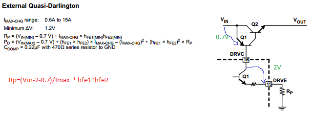

Don't you think that we should deduct 2 volts for a proper calculation of the Rp value.
