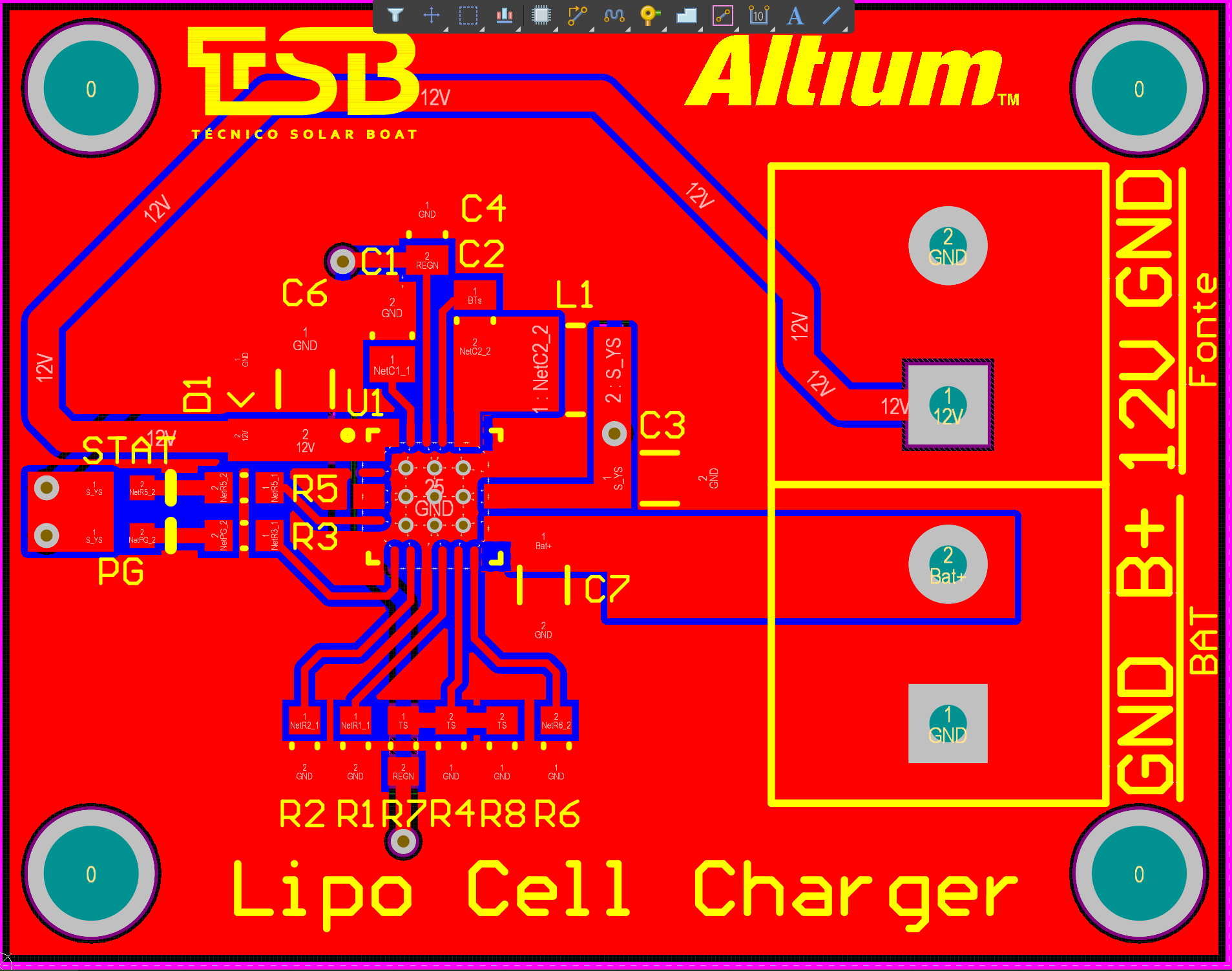

  • Since I last posted I've updated the PCB design, and after testing with different RICH values I came across another issue. When I'm using a RICH resistor with 430Ohms, I get the expected 1,5A current, but when I try a resistor with a lower value, I've tried with 240-330-360-390 Ohms, to get higher charge currents, the charger doesn't work and the STAT pin starts blinking really fast, so fast that it doesn't even have time to light up completely, It's way above 1Hz, why is this happening? Why can't I reach higher currents? Isn't this IC supposed to give upwards of 3A of charging current?
    Below is my PCB design.

    Based on your most recent response, I believe there may be some connection issue between your battery and the charger's BAT and GND pins. This may cause the STAT pin to oscillate at much faster pace or behave erratically. Another common reason is battery to BAT pin trace/line impedance. If this is significant, changing your resistors to higher charge current setting may force the charger into early CV/Termination, while not actually charging the battery fully. Try this test without a real battery first; i.e. using a power supply with the ability to sink current, or a constant voltage E-Load.
    You may also want to consider the power capability of your input source. Do you have this information?
    Additionally, please verify that the GND net in your first post's schematic is actually tied to the rest of the board grounds.
    I would also ask you to monitor the BAT pin voltage, rather than the cell voltage itself. This gives us a better approximation of what the charger is seeing.

  • 1. The battery connection can't be the issue, I've double checked everything and even tried changing cables, but it didn't yield better results.
    2. The BAT pin trace impedance is insignificant, since the track is very large, as you can see in the attached design.
    2. My input source was powerful enough, since i was using a 200W Lab PSU.
    4. All the grounds are connected in the PCB.
    5. I've checked the BAT pin voltage and it showed me the correct battery voltage.
    The big issue here is why the charger works with an higher RICH, which results in a smaller current, and fails to work with a lower RICH, which would provide a higher current. The charger is working perfectly with 1,5A, but it should also work with 3A when I swap the RICHG resistor.
  • Hey Sebastian,
    The reason I asked about the BAT pin voltage and the line impedance (which includes board trace impedance, contact resistance from the battery connection point, and battery lead resistance) is because when you are trying to push more current into the battery, you could be artificially pushing the battery voltage to the battery regulation point.
    Have you been able to take a waveform of both the BAT pin voltage and the current going into the battery? My thought is that the lower RICHG resistance is pushing the charger in and out of charging due to the higher current and higher battery voltage. If you are measuring battery voltage DC-wise, then you will only see average battery voltage. If you are measuring DC-current, again you will only see average current. This would also explain the erratic oscillation of the STAT pin as it attempts to charge, BAT voltage rises and immediately enters the termination threshold condition, stops charging, BAT voltage drops down to ~3.4V, and repeat.
    You will likely want to add the STAT pin as a channel in the waveform you provide.
