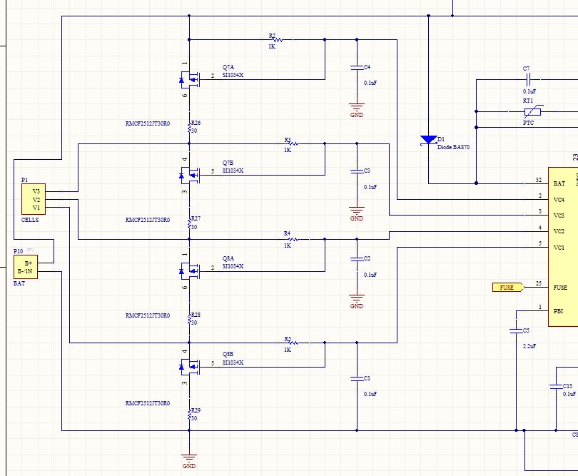

In Fast Cell Balancing Using External MOSFET (SLUA420), the example uses a bq29330, showing a connection for Cell 1 negative going through an Resistor/Capacitor filter to a pin on the 29330.
The 40z50 doesn't have this connection available externally (as described in SLUA660, Section 2.3).
So what is the recommended way to connect the external MOSFET for Cell 1?

    We recommend using a p-channel FET for the cell balancing circuit. for the bottom. A attached a graphic for reference.
    Tom
  • Dear Tom,
    do you have a more detailed AN for this option of BQ40z50?
    I noticed you did not place a filter capacitor in you drawing? should it be added between R3/pin VC1/2/3/4 to GND?
    can you comment on my implementation of eternal balancing?

    You will need to use a PFET to balance the lowest cell, but we recommend using NFETs for the other three. This is due to the implementation of the voltage sense / internal balancing circuits inside the device.

    bq40z50 external cell balancing.pdf
  • OK Tom, implemented.
    can you elaborate on the problem that the lower cell balancing creates for the system?
    regards,
  • Ran,
    Using the internal cell balancing, lower current, will require more time to balance the cells. It could take several cycles, if they are severely imbalanced. The internal cell balancing algorithm will allow you to balance cell simultaneously, where the external circuit will sequence through the channels.
    Tom

  • Tom,
    do you have a specific P&N-Channel-Dual-Mosfet you can recommend for external balancing?
    Simon
  • Simon
    We do not have specific FETs to recommend. We have used the PFET on the bq3060 EVM for cell balancing. A FET comparable to this will work for Cell 1 and a comparable NFET will work for Cells 2 - 4.
    Tom
