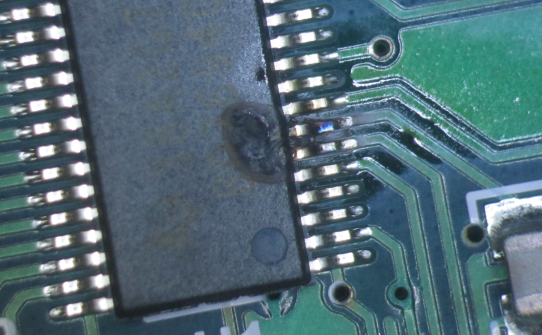

We are working with the BQ76940 EVM board and the BQ76940 chip on the board just blew. We are fairly confident that it is the LDO that burnt by looking at the image below. When measuring the resistance between BAT+ terminal and pin 7 on the BQ76940 chip, we now get a measurement of 7.7Ohm.

  • Hello Michal,
    From the image, the discoloration of pins 6 TS1 and 7 Cap1, it looks like there was a short between the two pins.
    • Cap1 is enables to the LEDs through a transistor and TS1 to c1 cell through the boot switch.
    • When the LEDs were on  there was no short to ground at that time.
    • Once the boot switch was pressed, this would have allowed a path from TS1 to Cap1.
    Check the state of SW1, the boot switch.  Also, remove what looks to be a bridge I between pins 6 and 7.
  • I am using the development board (BQ76940EVM), so there is no bridge between pin 6 and 7. We checked with a microscope to confirm this. The discoloration is on pin 7 and we don't think there was a short between the two pins.
    And I'm not sure how pressing the boot button would cause this. The boot switch was not pressed when this happened.
  • Hello Michal,
    Those were just points to check to troubleshoot this fault on the hardware side.  The SW1 does not have to be pressed, it could be faulty.  That is also the only path to c1.  Since Cap1 is connected only to the base transistor, as far as I can tell from the schematic, you can do some more checks to see where Cap1 has a route to the positive terminal.
    Your next step would be to remove the chip and check the traces again.
  • Note: I am going off of the bq76920EVM schematic.  The bq76940EVM Datasheet slvu925b crashes my browser when I got to the schematics section.  There could be some discrepancies in the design layout.
  • We have checked the board, the traces and the soldering and everything seems to be fine.
    We are still wondering what could have caused the problem.

  • Just to let everyone know, TI folks have been helping us offline on this one.
    It points to the EV2400.  Avoid using it to program the bq78350 until some update is available.
    Programming with EV2300 worked right away.  No smoke.
  • As noted the EV2400 does not program the firmware properly.  The result is the bq78350 draws excessive LED current overheating the LED dropping transistor causing it to fail.  This puts the battery voltage on the CAP1 pin exceeding its abs max and also feeds through the circuit and can exceed other pin's abs max.
    See the note on the EVM tool folders, use the EV2300 for programming at the present time
