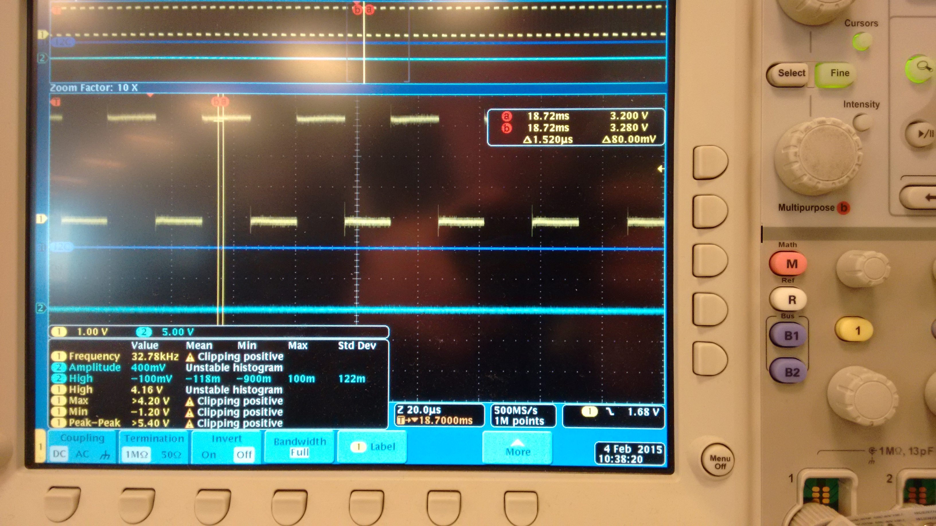

    Could you please measure the clock signal on pin 35 of the bq2084. It should be running at approximately 32 khz. If it is not there, then please check the 100K resistor on pin 33 and the filter circuit on pin 32. The lack of this clock, due to an external hardware problem, could explain your symptom.
  • I have done the mesure and this clock is present !!
