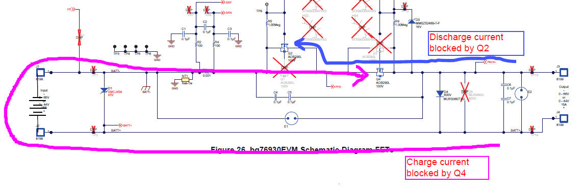

I am brand new to the TI battery chipsets, and have been looking at schematic for the BQ76930EVM. I'm having trouble understanding how the charge and discharge FETs are meant to operate. To my way of thinking the charge FET should be activated when you want to apply a charge from an external power source to charge the batteries, and the discharge FET would be activated when you want to control the output of the battery driving a load. When I look at the configuration on the schematic (Page 44 of SLVU925B) it looks as though both the discharge (for Q2) and the charge (for Q4) FETs would need to be activated to have current flow from J1 to J3. I do see the "PFD" node in the middle that creates an alternate path (through Q17) to J3 using the "pre-charge" control, but it still requires Q2 to be activated. I'm not sure how you would integrate a charge system into this configuration? Does this mean that for most operations both charge and discharge need to be active at the same time (or discharge in combination with pre-charge). Any help would be much appreciated. Thanks in advance.

    Each FET blocks current in one direction, so the charge FET controlled by CHG will block charging current, the discharge FET controlled by DSG will block discharge current. These are used in a lithium ion battery system to prevent over charge or over discharge of the cells. The battery should be operated in its safe region by the equipment connected, so normally both FETs will be on, at least when the battery recognized it is in use.  When the external equipment fails to operate the battery in a safe range, the battery will switch the FETs off.  Which FETs switches with which fault depend on the IC design and/or algorithm used for control.  The bq76930 typically switches off only the FET to block the current for the direction of the fault. If the charge FET turns off from overvoltage for example, the discharge FET remains on so the battery can be discharged. Discharge current can flow through the body diode of the charge FET while it is off, but this can lead to heating of the FET and potential damage. Some devices will implement a body diode protection mechanism to turn on the charge FET again if discharge current is flowing even though the cells are still in overvoltage.  Other devices will leave the FET off until the fault recovers and expect the battery designer to size the FET appropriately to handle that reverse current.  The bq76930 gives the determination and decision to the host, the bq78350 or other MCU.  If for example the OV fault is cleared and the FET enabled but the fault re-occurs the host will need to clear the fault and enable the FET again.
    When the charger is a simple CC-CV source and does not know or pay attention to what the battery voltage, the battery may implement a pre-charge circuit to reduce the charge current while battery cell voltages are below a set threshold. The pre-charge current can flow through the discharge FET body diode or through the main FET path if the discharge FET is turned on.
    The circuit function of the bq76930EVM considers the battery as a standalone system such as might exist with a removable battery.  The battery would be connected to a charger or to a load.  If you communicate with the battery in either the charger or load you will need to consider isolation of the signal lines with the low side switching.  If you have the battery implemented in a system with both a simultaneous load and charger you will typically need another level of current control to determine when the battery should be used or charged and when or if the system should operate from the charger. These switching functions are included in some ICs for single or few cell systems, but are not in the bq76930.  The bq78350 does not provide control for directing current between the charger, load and battery, only for protection of the battery.  If using the bq76930 with an MCU, more complex control could be implemented, additional FETs and appropriate FETs would likely be required.

    I do have a follow-up question  based on your response. On page 44 of SLVU925B showing the FETs interconnect for BQ76930EVM it seems that the batteries are intended to go to J1/J2  ("BATT" connection) and the output of the controlled system is intended to go to J3/J4 ("Pack" output) shown below. If I understand correctly the body diode conduction would run from Source to Drain so for Q2 (discharge FET) the FET would be in body diode conduction when discharging so even if the FET was off the battery could still discharge? Same but opposite for Q4 for charge. It seems like they should be the other way around based on your description. Am I missing something?

  • Hold on... I just realized this is a low side connection so the current paths are opposite right? Sorry for the trouble!

  • Right, remember it is low side and additionally the schematic is drawn with the positive on the bottom.  For other readers:
