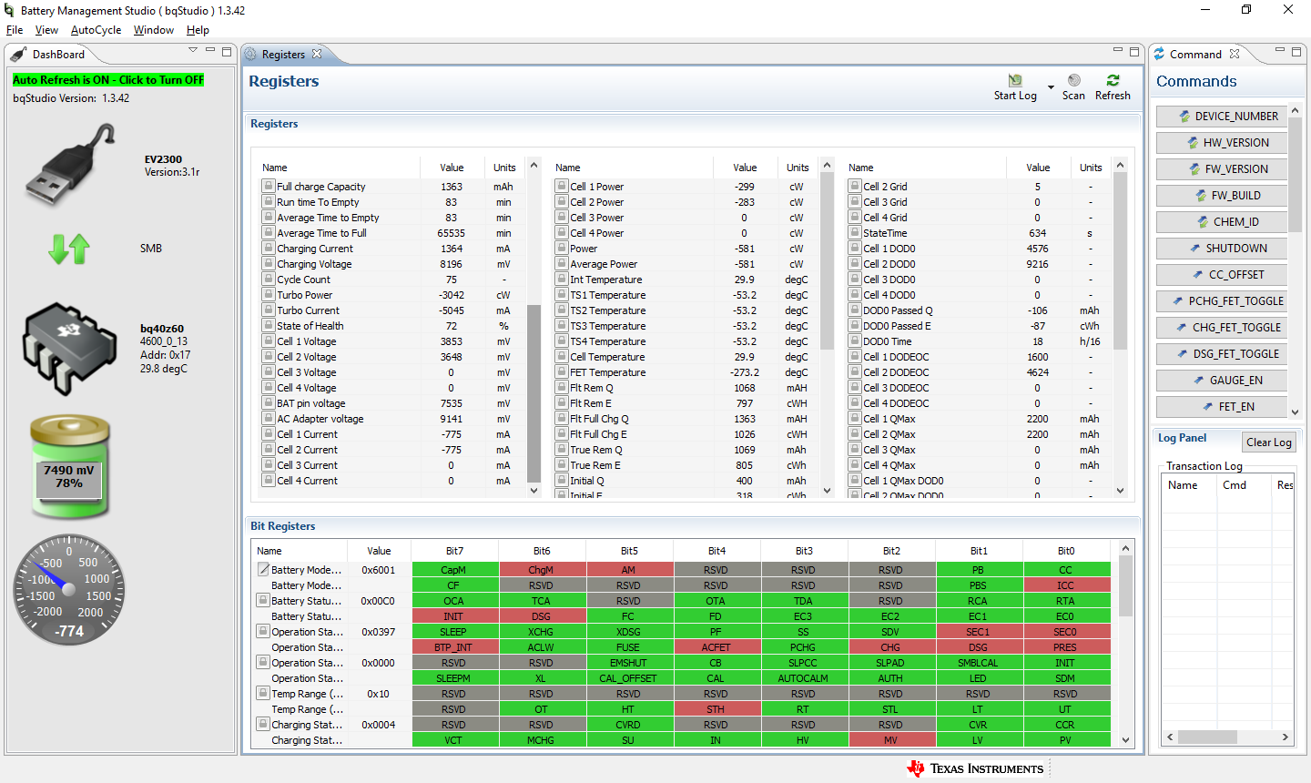

  • Hi Tom,
    I actually thought I had a resolution, but I still end up with voltage shown on the "AC Adaptor when the charger is removed;  I cannot get ACFET to turn off after removing charger voltage.  Here is a screen shot.  My charger voltage is actually 12.5V
  • I may have confused things a little. The screen shot is AFTER the charger has been disconnected.
  • Jim
    I still have not been able to reproduce this behavior on the bench. Can you send an srec file from your pack? I will send a private message to get the unseal codes.
    Tom
