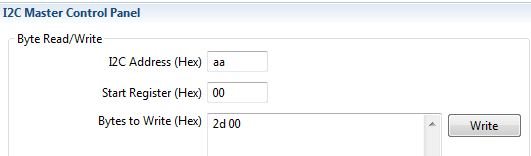

Hi I am unable to calibrate current & voltage with EVM2300 & getting following message -
" Calibration - failed to enter calibration mode with command 0x2D "
- any suggestions ? Thanks for any reply

Thomas I am using the GUI but yes the I2C Master Control Panel does have the same parameters that you have illustarted

In order to help who also has this problem, this post (https://e2e.ti.com/support/power_management/battery_management/f/180/t/464995) might help.

We used BQ studio for the calibration and settings ,You should ask Ti to help you solve your BQ Studio problem
