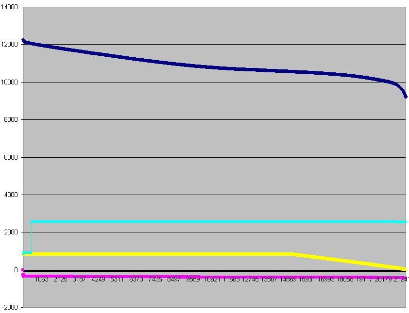

Pack Li-ion (3S), CF=0
This discharge cycle (blue - voltage pack , light blue - FCC, yellow - Remaining CC, magenta - current)
How to disable recalculation FCC during discharge?

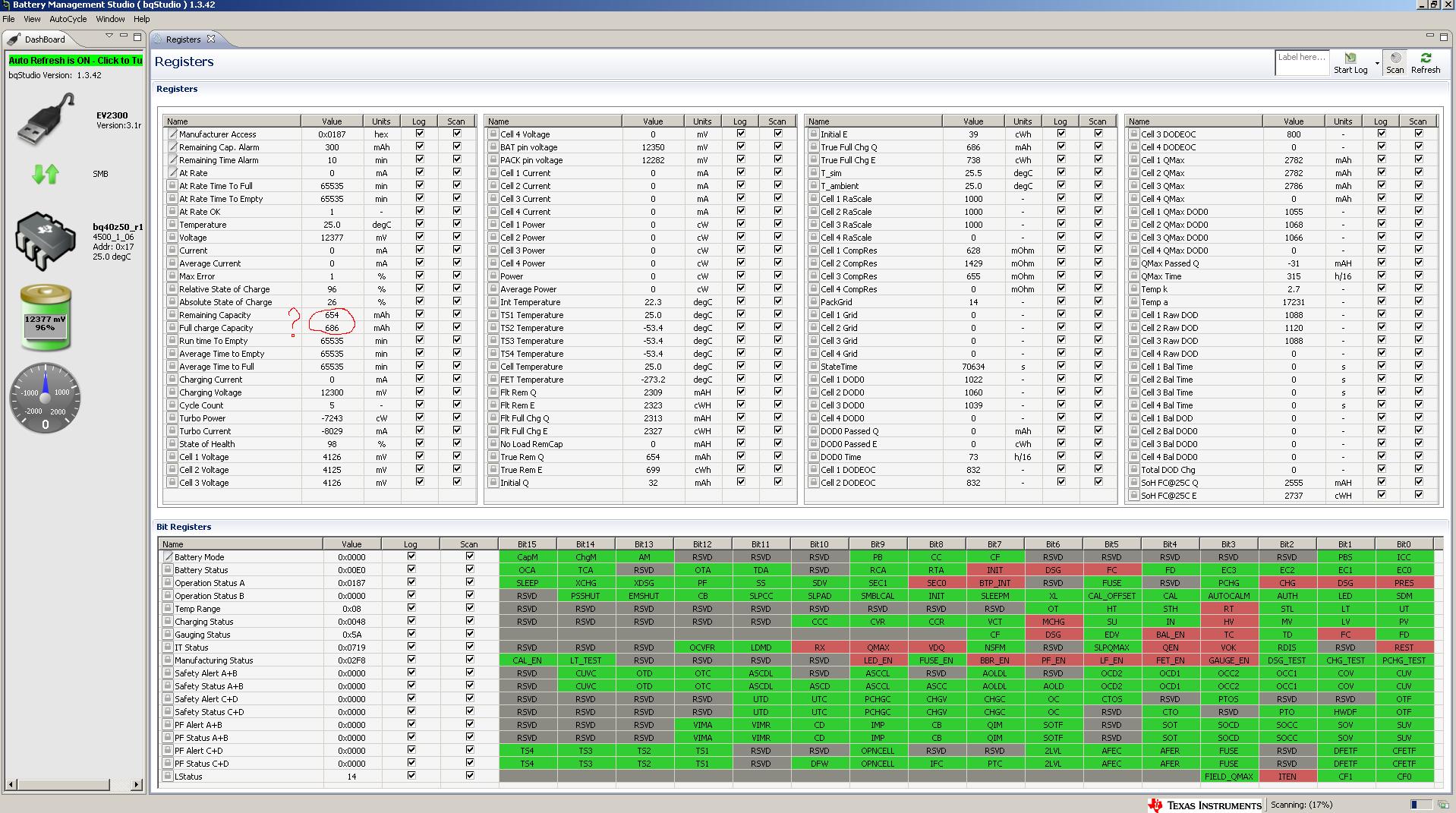

Very strange bug:
firmware bq40z50r1, successfull learning cycle, full charged custom pack, 2 hour relax and control REST bit, in attached picture discharge cycle (blue - voltage, magenta - current, brown - FCC, violet - remian capacity). What happens?! Why FCC=2500->1112 and RemCap=0?!
I attach log file and srec file:

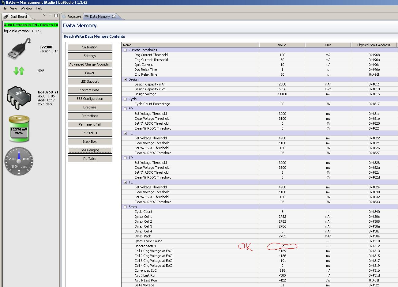

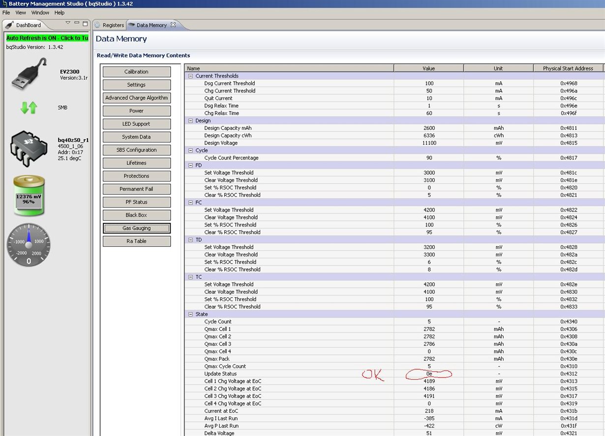

Srec make from official bq40z50r1 firmware and write to bq40z50 next algorithm:
- write original bq40z50r1 srec to bq40z50, reload bqStudio (v1.3.42)
- change chemistry from chemistry tab
- read flash memory and change setting to enable Gauge, FETs and etc
- write flash memory (tab "All") and command "Reset"

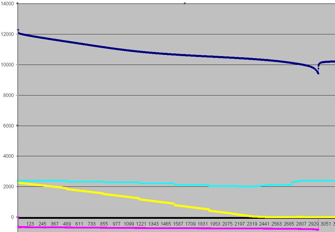

next cycle, next bug (lightblue - FCC, yellow - RemainCap, full charge pack, 2 hours relax)
log attached
