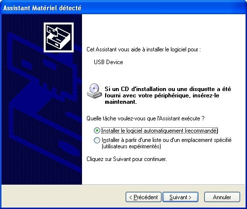

    I have the same problem. Since a couple of times the EV2300 is not longer recognised.
    Before it worked well but now he does not find the driver any longer. It must be something to do with the recognition of the USB-Device.
    I get only "USB Device detected". No name is displayed. So Windows can not associate the driver with the device.

  • My EV2300 stopped being recognized at one point and I got it to work again just by uninstalling EVSW and reinstalling it.  I'm not sure what that did with the driver or if it was related to the driver but it worked for me.  Try the "Uninstall bq Evaluation Software" in the program folder.
  • I tried this, but it doesn’t work for me. The EV2300 is recognized as a "USB Device".
    Then the driver installation does not associate the driver with the device:
    I installed the driver package before....
    Mat
