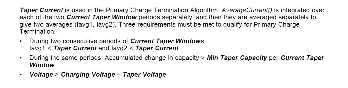

    Can you look at your log file to see if you are meeting the min taper capacity criteria. pls see snippet below that i got from the trm of a similar device.
    I would suggest since your taper current is 100mA, you set your charger to terminate charging at 75mA, and reduce your min taper capacity to 25mA.
    thanks

  • Perfect, thank you for answer. I think I understand it now. I read this in manual but make sense to me now thanks to your hint.
    I will update you about result.
  • Maybe I found source of problems, in bq27530 technical reference manual is written in same column as you quoted following:
    During the same periods: Accumulated change in capacity < Min Taper Capacity per Current Taper
    Window
    which have oposite meaning than yours text.
  • SOLVED.
    Your quotation was wrong, right is following:
    Window
    Beside this very helpful was graphing function of new Battery Management Studio. I observed that new battery cell required following settings:
    Taper Current: 130mA
    Min Taper Capacity: 25mA
    Window 40s
    now termination is properly ended with FC flag set.
    Thank you for hint. Please correct manuals with correct  < > signs to avoid future confuse.
