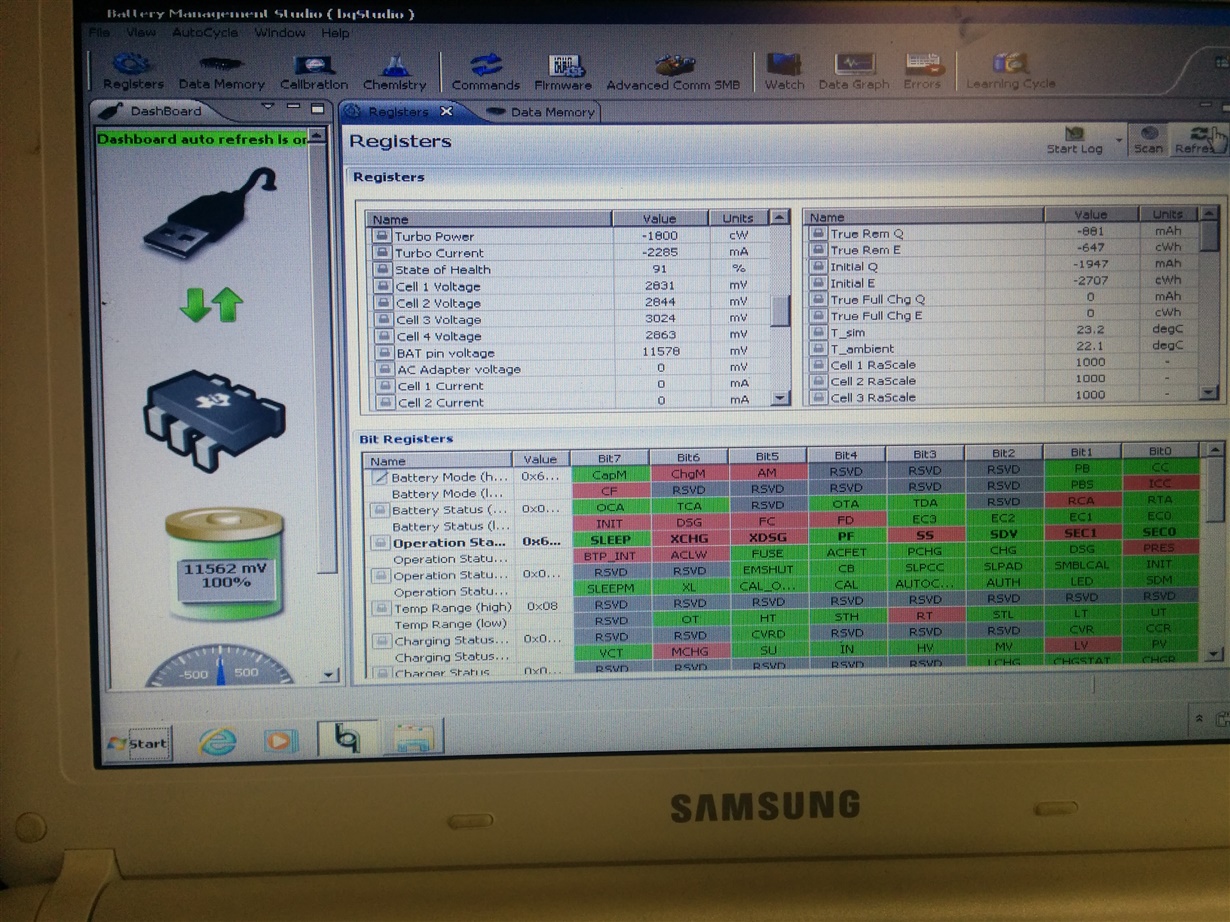

  • Dear Ben, Tom,
    Another piece of information that might prove to be useful:
    The registers XDSG and XCHG, as far as I understand the BMU functioning, would be ideally either On and Off, or Off and On.
    When the troublesome condition takes place, both are set high. Therefore, even after a full discharge, when XDSG is high, the XCHG has not been reset back to low; instead, it remains high
    What determines this condition? I could not find its root in the documentation.
    Once again, I appreciate your help.
    Best regards, and have a wonderful weekend,
    Daniel Gebbran
    *Image below for additional status*
  • It is acceptable to have both the XCHG and XDSG flags set at the same time. They are set to the opposite states of the CHG and DSG flags. The SS flag is set, indicating that there is a safety fault and it is CUV in your case. I would check to verify that the CUV threshold is set properly for your cells. The curious problem is that both the FC and FD flags are set. You probably have some setup problems. Please export an srec file and send it to us. You will probably need to return the gauge to Full Access Mode to export the file.
