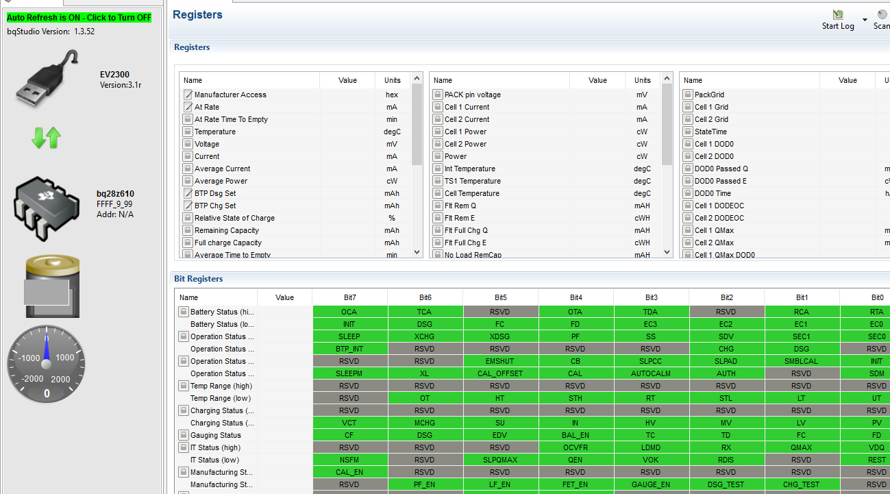

    When starting the bqStudio software and selecting the right fuel gauge, this is the result I get.
    After clicking "Ok" from the error box in the first screenshot, the program attempts to connect but fails as seen in the next two images.
    USB communication between the program and the EV2300 seem to be good.

  • Hi Blake
    Your device is not connected to the correct port on the ev2300. it needs to be connected to the i2c port and not the smbus port of the ev2300.
    You will need jumpers on the clock and data connectors ..i.e p2 and p3 for the device to work. Also, you need to press the switch to apply a postie voltage to pack p to wake the device up before starting bqstudio. Bqstudio automatically detects the device upon start up. you are no supposed to manually select either bqz files. pls refer to the user guide of the device for inital start up of the device.

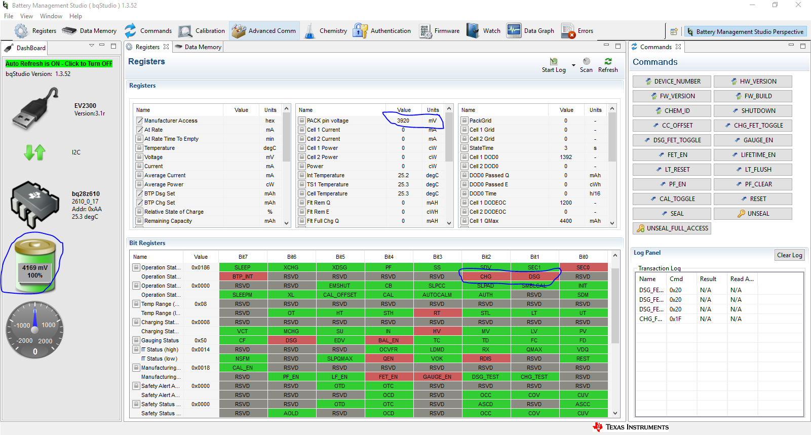

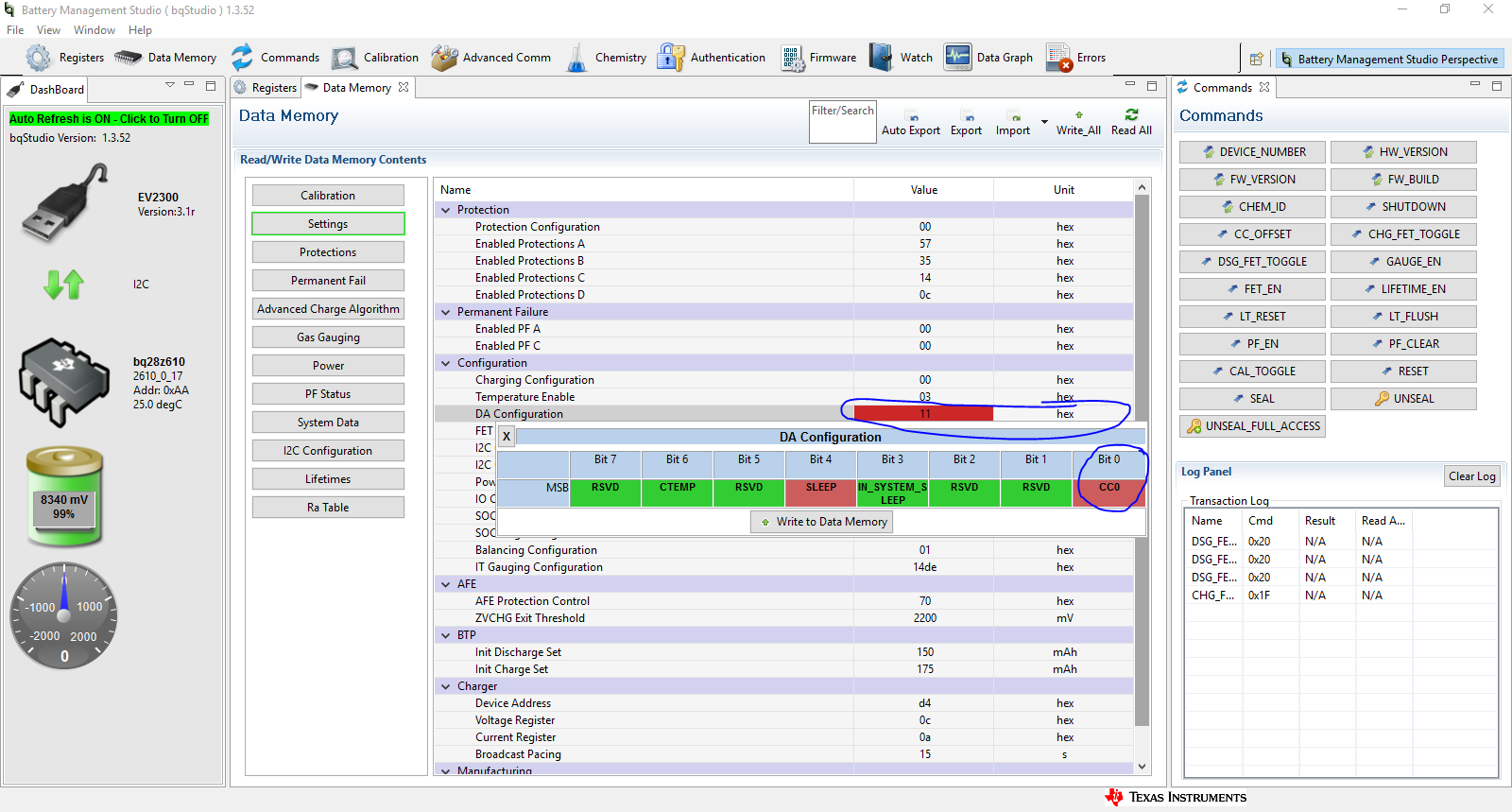

  • Yep, your suspicion was correct. A cell under voltage (CUV) condition was tripped causing the discharge FET to remain off. I figured this was due to my single cell wiring configuration. I added another cell in series and now the output is sustaining the pack voltage so that issue is fixed. The next step, since I need a single cell configuration, was to switch the CCO flag according to the user guidance document. In the "Data Memory", "Settings", "DA Configuration" menu, the CCO flag was by default set to hex code 11 and was red. I changed this to green and the hex code changed to 10. The fuel gauge didn't seem to care, however I would expect the CHG FET to turn off due to a COV condition. Here are some screenshots to clarify.
    Figure 1. DA Configuration set to two cells in series.
    Figure 2. Two cell DA Configuration with two cells connected on input terminals.

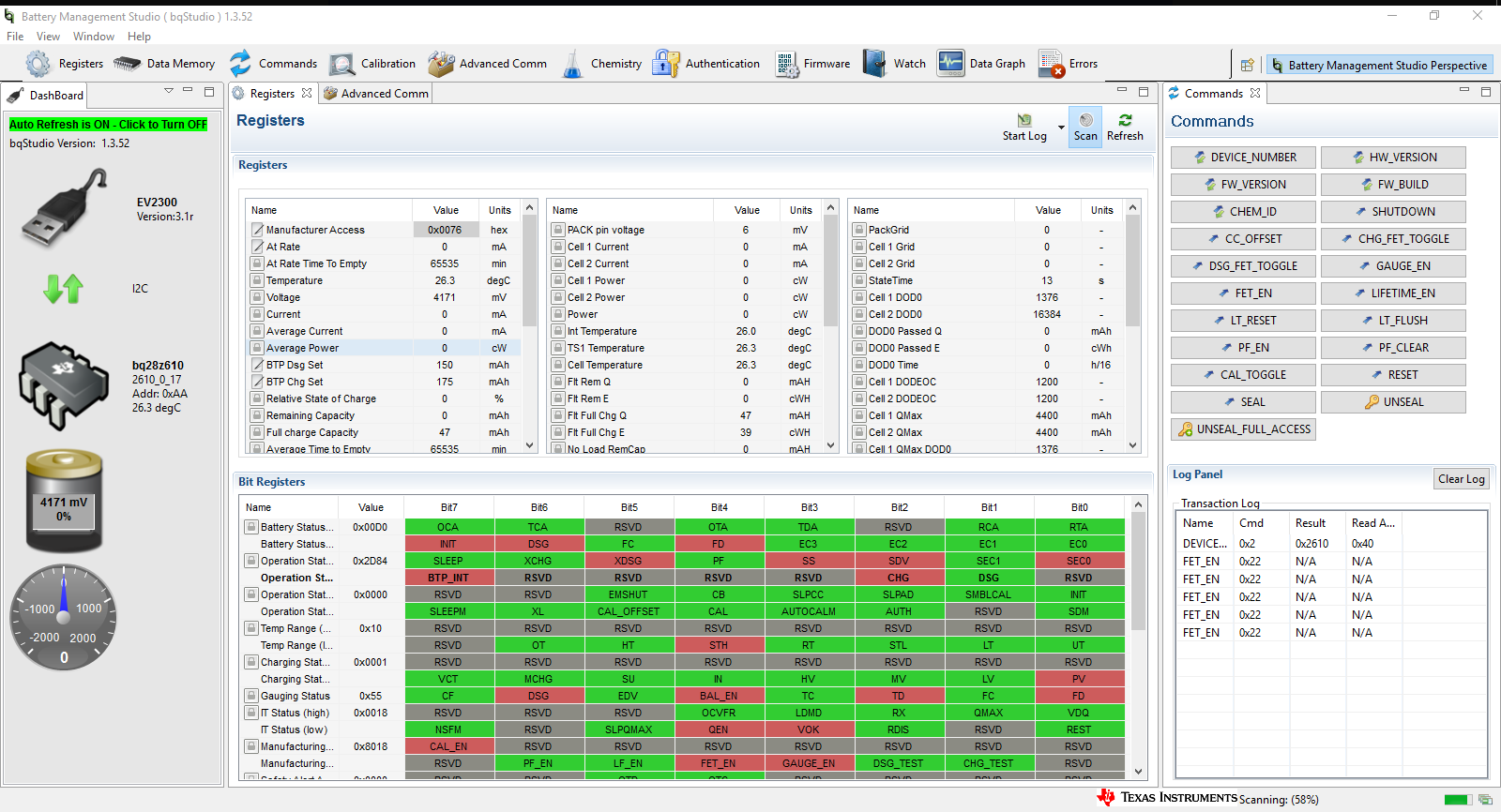

    Figure 3. DA Configuration set to 1 cell

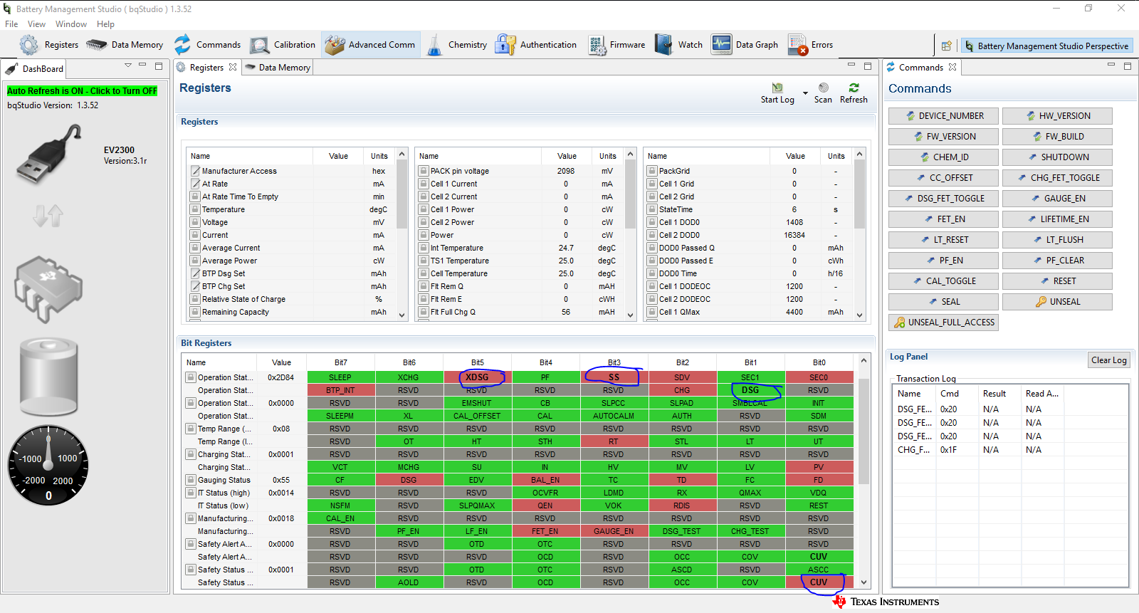

    Figure 5. One cell DA Configuration with a single cell connected.
    Figure 6. Two cell DA config with single cell connected Test 1
    Figure 7. Two cell DA config with single cell connected Test 2

    1) What does the CCO bit stand for? (figure 1) I was not able to find any information on "CCO" in the technical reference document for the bq28z610 or online. It is only briefly mentioned in the user guide.
    2) Why is the COV flag not triggering when the CCO bit is set for single cell config and two cells are connected? (figure 4)

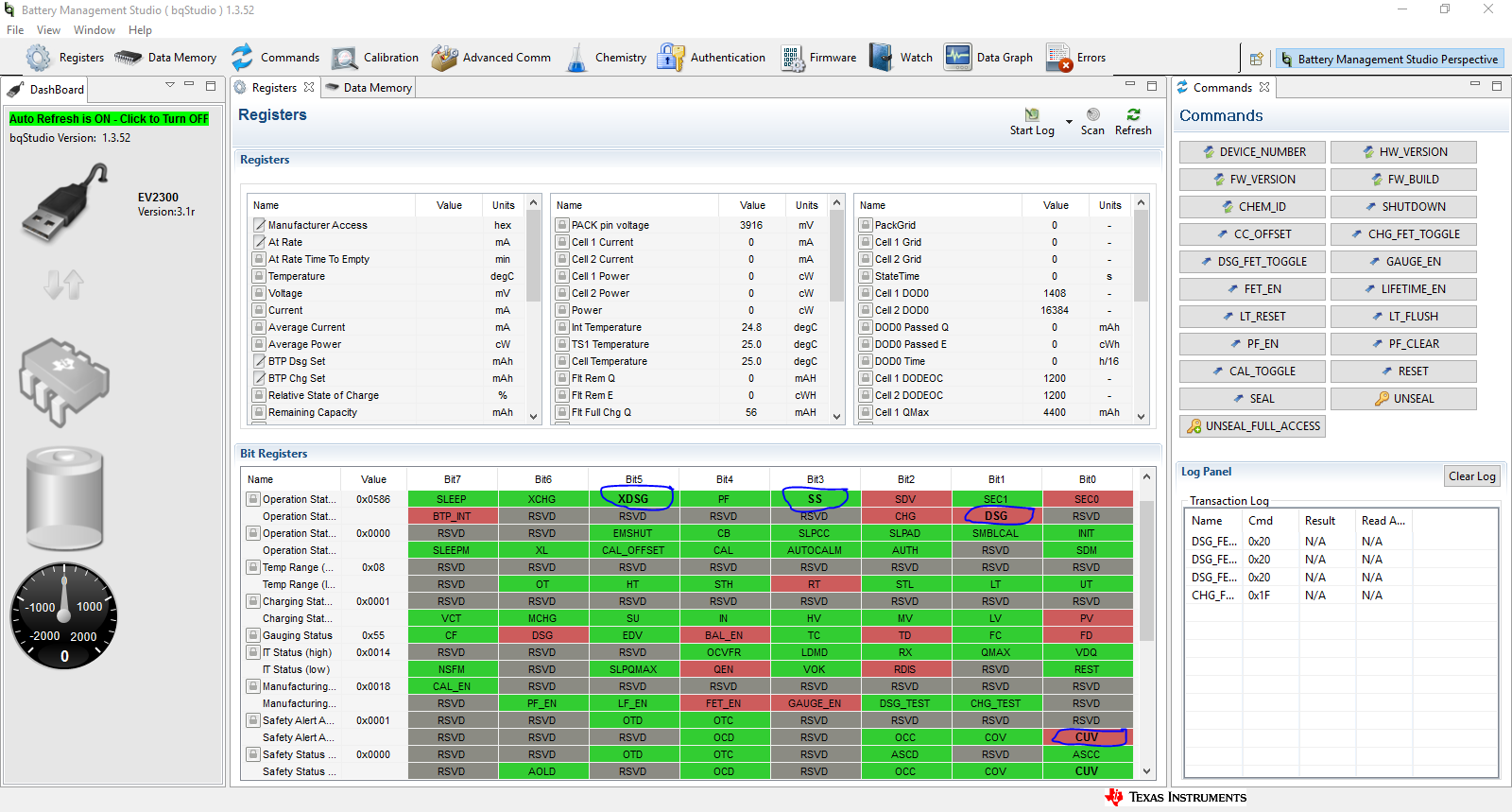

    3) Why is the "PACK pin voltage" always lower than the battery icon in the dashboard? (figure 5) Multimeter voltage measurement on the pack terminal on the board verifies that the battery icon is correct, not the "PACK pin voltage" value.
    4) This last question regards figures 6 and 7. I switched back to the two cell DA config setting with one cell connected and kept on waking up the IC and refreshing the screen just to see what would change and I noticed two things. First, XDSG, SS, and DSG kept changing almost every time I woke up the chip and refreshed the screen. Second, in figure 6, DSG FET is on according to the screen and the CUV condition is met. This indicates that the IC recognizes that the voltage is too low (because it is expecting a two cell battery) and yet is still allowing the battery to discharge which is obviously not good, unless this is a false positive. I'm not really concerned about this since I will be using the fuel gauge in a single cell configuration, but thought I would mention it.
    I apologize for the long post, but I hope I gave sufficient information to back up my questions.
    Thank you for your time Onyx.
    -Blake
  • 1. Setting that flag indicates the device is setup for 2s config. Clearing means it is set up for 1s.
    2. When you  clear the cco flag, the device is configured for 1s. the 1P pin (vc1) is reading just the voltage of cell 1 so there is no way you will get a COV. except there is an actual over voltage condition
    3. pack p  voltage can always be calibrated using  bqstudio. Do not worry about it's accuracy as the packp voltage is not used for any significant gauge calculation. The primary function of that pin is for charger detection to wake  the device from shut down mode
    4. The EVM should be used as  stated in the  user guide. if 1s is used, 1p should be shorted to 2 and just 1cell should be used
    -Onyx
