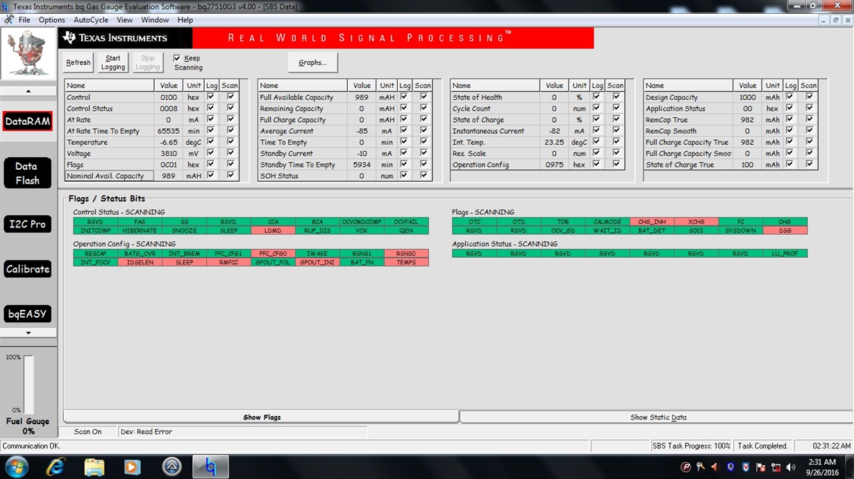

I have soldered the TI Provided BQ27510-G3 (Got samples) chip on to the bq27510EVM board and powered with 3.8Vdc battery. Using oscilloscope, Observed that the LDO output at TP3 is 2.5V and in few seconds, it went to nearly the battery voltage ~ 3.7Vdc.
I have used the Eval board received from TI (as is, without any change), with the same battery and load (LED with resistor), it works fine and I am able to see the Flash data and able to read gg files and load the DFI image from bqEASY software.
After the new chip installed, I am just powered and observed this failure. This behavior was observed in actual product and it is doubted some interface problem causing chip failure. But in Eval board itself the chip gets fired without connected with any controller. Is there any way to hold the chip from running into unstable LDO output? Any suggestion would help me a lot.
Thanks!
  • Did you also see these problems on a non-modified EVM board? What version of the bq27510 was installed on the EVM?
  • Also, Check to make sure your chip is properly soldered and there isn't any shorts any where.
  • There is no problem with non-modified EVM board. No abnormalities observed even when I changed multiple parameters. I am able to update the gg file and verified with inputs. I found the below fields are not updated. I set the parameters : IT Enable        = 01; Cycle count 0 = 8; Qmax cell 1    = 719; But even after programming the new configuration it shows : IT Enable        = 00; Cycle count 0 = 0; Qmax cell 1    = 715; Is that fine?
  • I have done the soldering verification and it looks fine. This failure is happening 4th time. Is there any possibility of data crash happening in flash memory inside the chip during soldering?
  • Rajesh,
    The gauge is supposed to be able to have those parameters changed with the importation of a gg file. Can you check to make sure the device isn't sealed. This will prevent a gg file from being imported. Does the 2.5V pin on the EVM measure that voltage? Can you try programming the iC with the default firmware to see if that helps?
    thanks
    Onyx
  • I can measure 2.5V at the LDO output and read the flash content in the bqEASY software for few seconds. After certain time (30 - 60 sec) the LDO runs unstable and reaches the input voltage of 3.6V. This internal LDO failure was happening even if the programmer is not connected.
  • can you take a picture of your set up and post on here. it is weird for the LDO to go unstable.
    Onyx
  • I have found new behavior in the same eval set up.  Again I repeated the set up and tested. The communication is okay for half minute and able to read the gg file. Then the RAM values go in red in screen, though I am able to read the gg file. Few hours later without disturbing the set up, I have powered and able to see the communication okay again but for few seconds only.
    I believe the chip is live but some other thing must be wrong. Enclosing the gg files before and after the failure (Means that red screen) of communication. I will post you the set up picture tomorrow.

  • Hi Rajesh
    Can you pls send a picture of your set up  and also a picture of the register window of bqstudio or bqEVSW when the device is connected and communicating
    thanks
    Onyx
  • Enclosed the images of set up and the bqEASY screen shots when the device communication is okay.
    BQ failure images.zip
  • Hi Rajesh,
    A few things i noted.
    -BqEVSW shows your cell voltage being read as 0. pls check your cell connections and measure your cell voltage to ensure that the device your cell is not shorted.
    - Secondly, it appears your battery has an internal thermistor, given i see from the photos that you have a third wire comming from your battery. You only need one thermistorconnected to the ts connector on the EVM. Either you use only the external thermistor or you use that of the battery. Do not use both.
    -Third, disconnect your load,i.e the LED and resistor so we determine if that is contributing the issues you are seeing.

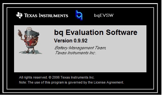

    - What version of EV2300 firmware are you using? Can you connect the ev2300 and then start bqstudio. bqstudio would let you know what version of firmware is on the ev2300. The version will be on the dashboard of bqstudio on the left hand side.
    -Finally if you have extra ICs, can you swap the IC on your EVM?
    thanks
    Onyx
  • Onyx Ahiakwo said:
    Hi Rajesh,
    Yes. Initially when the cell is connected, the bqstudio reads the actual voltage. In few seconds, the voltage drops to 0 and no more values visible.
    Okay. In fact, For checking purpose, I tried to use external thermistor. Now, I have removed the external Thermistor and connected the third wire from cell at TS pin.
    As recommended, I have removed the entire load. Now the set up has no load.
    Enclosed the screen for the firmware version detail. Please have a look at it.
    I have tried it already. Both time I am observing the same behavior. Anyhow, I will try it once again and let you know the status.
    thanks
    Onyx
  • I have replaced with new chip and made the set up again. The bqeasy software finds the device and able to read all the RAM and Flash data. I left the set up to 30 minutes without disturbing and taken the log. There is no abnormal activities.
    It was communicating well but the temperature reads as -35 deg a the LDO output reads as 3.6V, I am not able justify how it works if the LDO is not working. I have disconnected the battery and connected again, there is no communication further.
    Sometime the battery status percentage bar is not showing anything even there is communication happening. What should cause this type of error?

  • Hi Rajesh,
    To know the version of firmware on your ev2300, you need to install bqstudio. The left hand portion of the dashboard of bqstudio when it is started will let your know what version of firmware is on the device. The latest version is 3.1r
    thanks

  • I have installed and verified that the firmware is 3.1R. It seems the bqstudio have lot of menus and command in buttons. Is it safe to use. Is there any document to learn how to use it for writing golden image.
