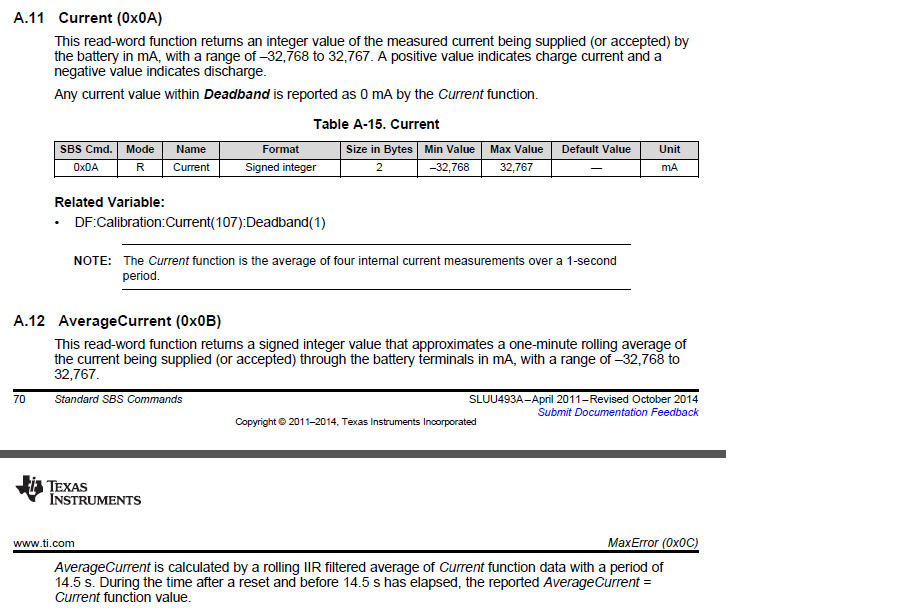

  • Hi Mike,
    I saw the 14.5 sec on page 70 of SLUU493A.pdf.
    I'm interested in the 6 or 7. But how is the 7 exactly computed?
    Alex
  • Alex,
    regards 7, page 190 of sluu493a
    so the part is using the Maxium of the AverageCurrent Values , which I take to be the 14.5 second rolling averages described on page 70/71.

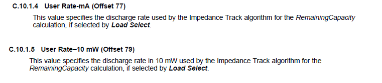

    Option 6 uses whatever value you specify in gg file for the User rate, ref page 184
    Don't confuse the User rate setting and the At rate setting which is used by option 5
