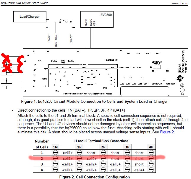

  • Are you attaching the cells to J1 and J5 terminal blocks ?
    Take a look at the EVM Manual's section 2.3 "EVM Connections" for the proper connection method, www.ti.com/.../sluuav7b.pdf

  • Hi, first off thank you for your quick reply. When I first started the EVM, I did it step-by-step as in the Manual suggested. There was no reply by the management software. As soon as I removed the Battery pack, the software did connect to the EVM. My Batterys are Ok, I checked them
  • thank you for your reply. I connected a supply voltage. Otherwise there is no connection to my PC anyway and i pressed the wake button also. Still no ack, when I connect any Battery to the EVM. I did everything as it was provited in the manual: connect cell1 first and shortfuse all open connectors, in my case that is j3 to j5, as i use 2 series cells.

    Your schematic to EMV for 2 cells in attach

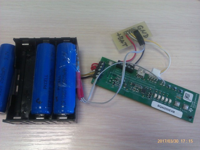

  • I took my the old prototype (3 cells, 2 years ago) and switched to 2 cells. Rewrite CC[1,0] to CC[0,1], make correction to Design Voltage and Voltage Termination..
    Pack work is fine - make charge/discharge, and work with bqStudio w/o external power..
    see in attach my EVM (accums Li, unprotected)
    If your can't clear PF, maybe your bq40z50 in sealed mode.. Or the alert is permanent.. Show screenshot from your bqStudio..
