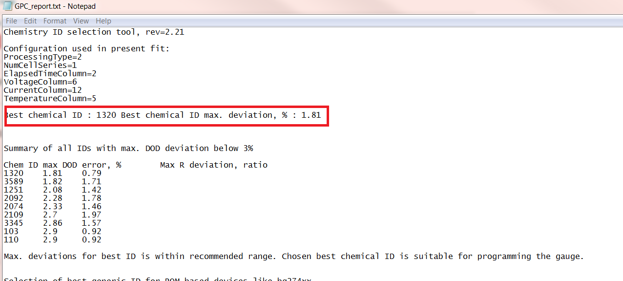

    1) Please use the GPS tool report for battery chemistry match with the lowest deviation as shown in photos attached.

    We already executed the measurements, needed for chemistry ID selection 4 times. Only in two cases, we get the same chemistry ID suggested by the GCP. The results are as follows:
    1)
    Chem ID max DOD error, % Max R deviation, ratio
    Best chemical ID : 3164 Best chemical ID max. deviation, % : 2.6
    Summary of all IDs with max. DOD deviation below 3%
    3164 2.6 0.3
    455 2.89 0.22
    2)
    Best chemical ID : 1305 Best chemical ID max. deviation, % : 3.82
    0 0 0
    3)
    Best chemical ID : 2033 Best chemical ID max. deviation, % : 2.72
    2033 2.72 0.28
    4)
    Best chemical ID : 1305 Best chemical ID max. deviation, % : 2.38
    1305 2.38 0.45
    2073 2.79 0.55
    2033 2.99 0.47
    Is ti normal, to get this much of a spread?
    The only ID, seen twice, is 1305 . Should we take this one for this particular battery?
    The measurements were done with the use of thew BQ GDK at room temperature in your lab.
    However the battery was not in the temperature stable enviroment (we did not put it at the time into the temperature chamber). Can the temperature deviations be the cause of this inconsistent results?
    Again, thank you for your excellent assistance.
    Best regards, I
    The results you got as a match ChemID for your battery are ok but you can get better results if you follow the recommendation for finding ChemID in the link below:
    Please make sure to charge the battery at C/2 rate to the Max. charging voltage of the battery (you can find it in Battery datasheet), then discharge at a rate between C/5 - C/10 to a terminate voltage of 2.8V - 2.9V to get the battery voltage profile so the tool can find a close match. Battery temperature during chg/dish can affect the results if there was a significant temperature variation and it is recommended but not required to attach external temperature sensor on the battery while longing data to be submitted to CHEMGPC tool.
    As for the spread results, the tool will try to find the closest match to your battery voltage profile and not the exact match and that's why you may see some deviation in the results. An exact match to your battery can be found if you send us your battery and we can characterize it in our labs to give you exact ChemID but this process requires 3-4 weeks after we receive the battery.
    Haidar
