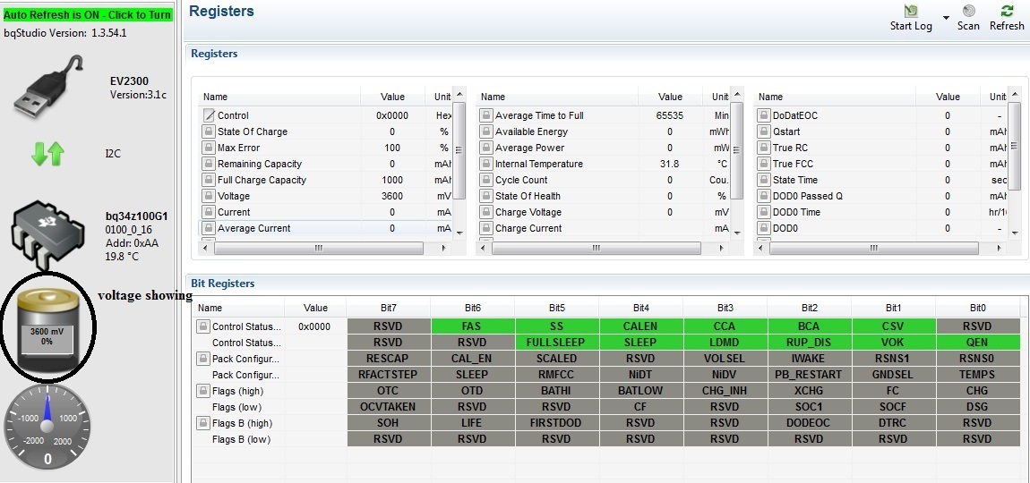

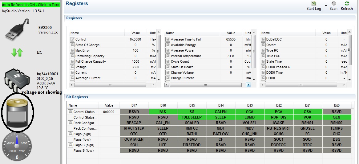

I made my own pcb for bz34z100-g1 ic.all connections are properly working.but i cannot continuously communicate with IC.i here with attach two photos with rounded mark for your verification.

Hi Arun,
Pls update the firmware version on the ev2300 from version 3.1c to 3.1m or 3.1r . I have attached one of the firmwares ... Hopefully this should rectify your issue.
