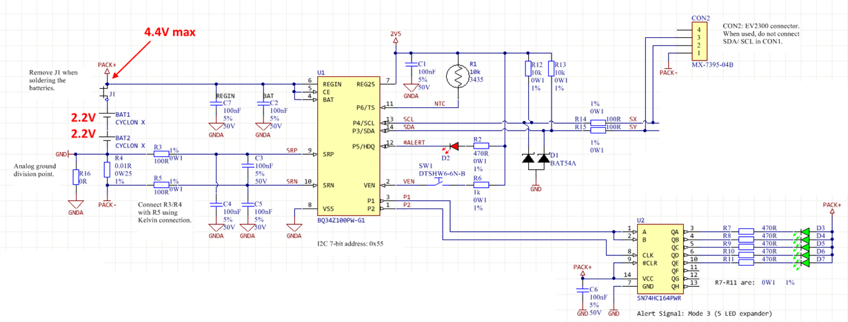

Hello there,
At this point I am clueless on why is my BQ34Z100-G1 config still not working. The SoC shows 0% all the time, even thought the batteries are fully charged. I will describe my application here with all the steps I took in order to configure the device. I would appreciate all help regarding this topic.
Here is the relevant chunk of my schematics. I have removed all parts that could make it more difficult to read it:
The parameters for a single cell (there are 2 connected in series in the design) in my application are the following:
  1. Max charge voltage: 2.2 V
  2. Min charge voltage: 1.65 V
  3. Capacity: 5000 mAh
  4. Max energy: 5000 mAh * 2.2 V * 2 cells = 22000 mWh
  5. Exact cell model: Cyclon X from Enersys: www.batterystore.com/.../

  • Hi Lukasz,
    Thank you for your well worded and clear post.
    Most gauge settings for the bq34z100-g1 are oriented around single cell values.
    In the schematic above, a 2s1p configuration is shown, however, the max energy calculation performed in step 4 above is for a 2s2p pack with 5000 mAh cells. If your pack is 2s1p, the max energy should be 11000 mWh.
    The cell charge voltages look to be for lithium cells instead of lead acid. Please note that the default settings are for lithium batteries. As a rule of thumb, If you open up bqStudio and click on 'import defaults' values that are near 4200 mV (indicating max voltage) should be modified to the max voltage of your lead acid cells (shown above as 2.2 V). Please set values correspondingly (Li-Ion cell values -> Lead Acid cell values) Please fix these values, such as the cell terminate voltage.
    If you only have 1 cell connected, please set the series value to 1.
    Interestingly, since you have such a low voltage (below 5 V), the external voltage divider does not need to be utilized for your device. If you'd prefer to use the internal voltage divider, please set the jumpers on the EVM to <5 V mode and set VOLTSEL = 0. Also, please update the VOLTAGE DIVIDER parameter in dataflash to be 5000.
    With respect to chosing the chemID for your battery, using the chemID given by the manufacturer (if given by the manufacturer) is recommended. If the manufacturer has not given a chemID with the cell, please use the GPCCHEM tool to determine a matching chemID. The tool and instruction pdf are found at: http://www.ti.com/tool/gpcchem
    Please make these modifications to fix your SOC.
    If the issues persist, please include a gg.csv file, log, and description of the issue.
    Sincerely,
    Bryan Kahler

  • Hi Lukasz,
    The default values for the device are set per-cell for lithium cells (on the order of 3000-4200 mV). Please ensure these values properly reflect per-cell your lead acid cell values (on the order of 1200-2000 mV). Please consult your cell datasheet for this information.
    Please set your Flash Update OK Cell Volt = 1000 mV.
    In addition, for default values with lead acid cells, please set:
    Configuration>Pb Temp Comp = 25%
    Configuration>Pb Reduction Rate = 10%
    Default Load Select = 3
    Cell Term V Delta = 100
    Min % Passed Chg for 1st Qmax = 50
    If the SOC issue is still seen after making these changes, please upload your gg.csv for analysis.
    Sincerely,
    Bryan Kahler

  • Hi Lukasz,
    Just a few notes from reviewing your gg file:
    Assuming the nominal voltage of your lead acid cell is 2 V and a capacity of 5000 mAh, please make the following changes:
    "Configuration","Data","Design Energy","10000","MilliWattHour"
    Modify the following parameters to work with your single cell voltages. These are extremely out of range for a lead acid application:
    "Configuration","Discharge","Cell BL Set Volt Threshold","2800","mVolt"
    "Configuration","Discharge","Cell BL Clear Volt Threshold","2900","mVolt"
    "Gas Gauging","IT Cfg","Cell Terminate Voltage","3000","mVolt"
    "Gas Gauging","State","Cell V at Chg Term","4200","mVolt"
    In addition, load your chemID using the CHEMISTRY tab followed by enabling IT prior to running a learning cycle.
    A chemID that matches your cells is ***required*** for IT Gauging (device functionality).
    For more information on how to determine the chemID for your cells, please see the gpcchem tool and documentation at: ti.com/tool/gpcchem
    Please review your LED configuration. Only 5 LEDs are seen in the attached schematic, but it is currently configured for 7 External LEDs.
    "Configuration","Registers","LED_Comm Configuration","63","flags"
    For more information on these parameters, please refer to the Datasheet.
    Sincerely,
    Bryan Kahler
  • Hello Bryan,
    After your revision things seem to start working! Thank you very much.
    I only have 1 question left:
    1. When I select Chemistry -> My desired battery chemistry (Enersys Cyclone_D) and program it using "Program selected chemistry" button, it tels me that the database is out of date. So I downloaded the new one and installed it, but after that I still receive the out of date message.
    Do you kno what could be the case?
