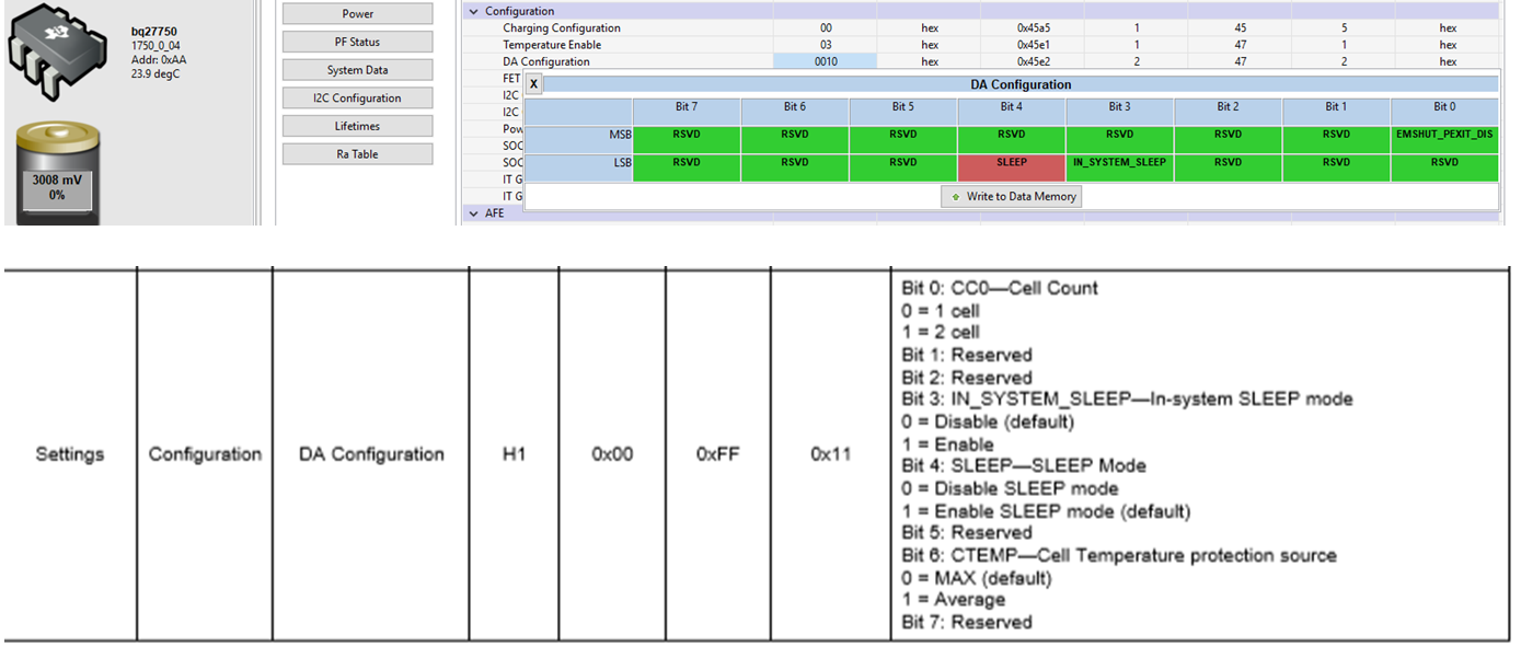

DA Config
Could TI please elaborate on the function of EMSHUT_PEXIT_DIS?

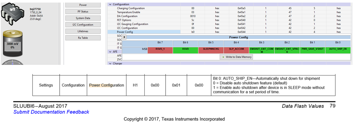

Power Config
The TRM only describes Auto_Ship_EN in this register, could TI please elaborate on the function of the rest of the bits?

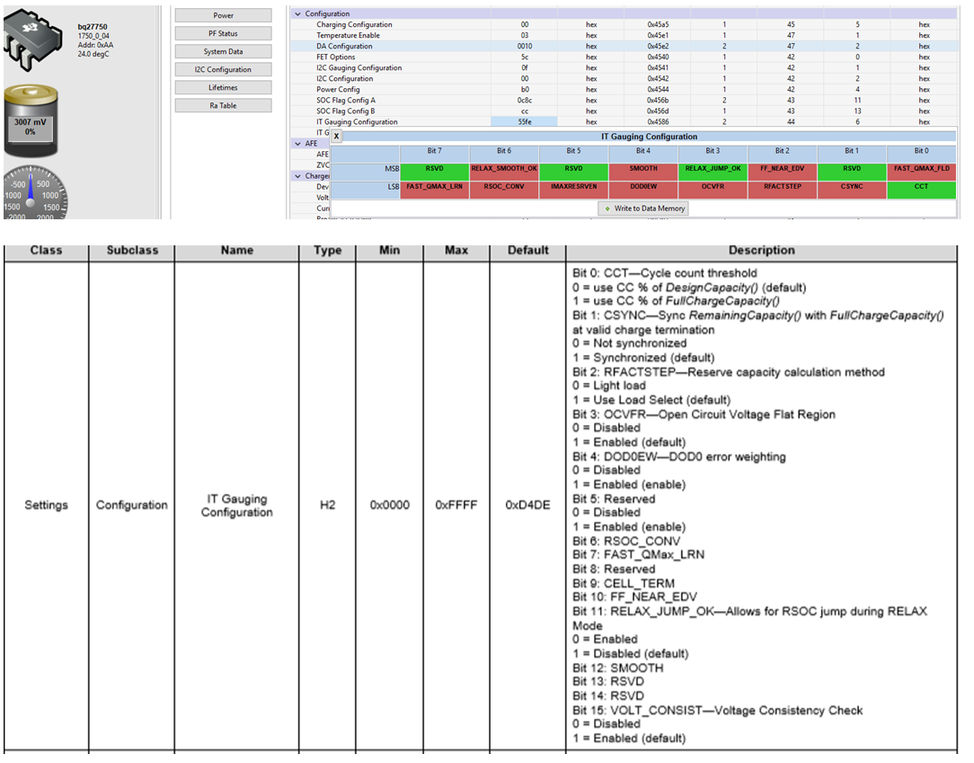

IT Gauging Config
Fuel gauge bits in question are Imaxresrven, fast_qmax_fld and relax_smooth_ok

    1) All of the following bits serve no purpose in this FW and the feature is not included
    EMSHUT_PEXIT_DIS, EMSHUT_EXIT_COMM, EMSHUT_EXIT_VPACK, PWR_SAVE_VSHUT
    2) SLP_ACCUM - This will add charge accumulated in sleep mode to the passed charge counter
    3) SLEEPWKCHG - Device will exit sleep mode on entrance to charge mode
    4) [SMOOTH]: A change in temperature or current rate can cause a significant change in Remaining
    Capacity (RemCap) and Full Charge Capacity (FCC), resulting in a jump or drop in the Relative State-of-
    Charge (RSOC). This function provides an option to prevent an RSOC jump or drop during charge and
    discharge.
    If a jump or drop of RSOC occurs, the device examines the amount of RSOC jump or drop versus the
    expected end point (that is, the charge termination for the charging condition or the EDV for the discharge
    condition) and automatically smooths the change of RSOC, and always converges with the filtered (or
    smoothed) value to the actual charge termination or EDV point. The actual and filtered values are always
    available. The [SMOOTH] flag selects either the actual or filtered values are returned by the SBS
    commands.
    [RELAX_JUMP_OK] and [RELAX_SMOOTH_OK]: When the battery enters RELAX mode from CHARGE
    or DISCHARGE mode, the transient voltage may change to RSOC as the battery goes into its RELAX
    state. Once the battery is in RELAX mode, a change in temperature or self-discharge may also cause a
    change in RSOC.
    If [RELAX_JUMP_OK] = 1, this allows the RSOC jump to occur during RELAX mode. Otherwise, RSOC
    holds constant during RELAX mode and any RSOC jump will be passed into the onset of the charge or
    discharge phase.
    If [RELAX_SMOOTH_OK] = 1, this allows the amount of the RSOC jump to be smoothed out over a
    period of Smooth Relax Time. Otherwise, the additional RSOC jump amount will be passed into the
    onset of charge or discharge phase.
    If both flags are set to 1, the [RELAX_JUMP_OK] = 1 takes higher priority and the RSOC jump is allowed
    during RELAX mode.
    5) Fast QMax Update Conditions
    The Fast QMax update conditions are very similar to the QMax update conditions with the following
    differences:
    • Instead of taking two OCV readings for QMax update, Fast QMax update requires only one OCV
    reading, AND
    • The battery pack should discharge below 10% RSOC.
    The differences in requirements allow the Fast QMax feature to have a QMax update at the end of
    discharge (given one OCV reading is already available and discharge below 10% RSOC) without a longer
    relax time after a discharge event. Typically, it can take up to 5 hours in a discharge state to ensure the
    dV/dt < 4 μV/s condition is satisfied. The Temperature, Delta Capacity, Voltage, and Offset Error
    requirements for QMax update are still required for the Fast QMax update.
    This feature is particularly useful for reducing production QMax learning cycle time or for an application
    that is mostly in charge or discharge stage with infrequent relaxation. Setting IT Gauging
    Configuration[FAST_QMAX_LRN] = 1 enables Fast QMax during production learning only (that is,
    Update Status = 6). When setting IT Gauging Configuration[FAST_QMAX_FLD] = 1, Fast QMax is
    enabled when Impedance Track is enabled and Update Status ≥ 6.
    6) IMAXRESEN - This will include the set Reserve capacity in the IMAX calcualation
