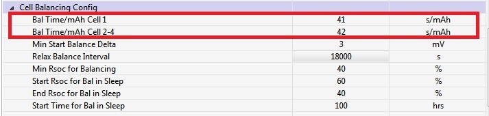

  • Can you provide more detail about your expectations, and the conditions when cell balancing is not behaving as expected. A log showing the behavior would be useful. Please ensure that the registers for cell balancing are set as you need to get the expected behavior. This is what you have set in the .gg file you sent previously.
    Advanced Charge Algorithm Cell Balancing Config Bal Time/mAh Cell 1 41 s/mAh
    Advanced Charge Algorithm Cell Balancing Config Bal Time/mAh Cell 2-4 42 s/mAh
    Advanced Charge Algorithm Cell Balancing Config Min Start Balance Delta 3 mV
    Advanced Charge Algorithm Cell Balancing Config Relax Balance Interval 18000 s
    Advanced Charge Algorithm Cell Balancing Config Min Rsoc for Balancing 40 %
    Advanced Charge Algorithm Cell Balancing Config Start Rsoc for Bal in Sleep 60 %
    Advanced Charge Algorithm Cell Balancing Config End Rsoc for Bal in Sleep 40 %
    Advanced Charge Algorithm Cell Balancing Config Start Time for Bal in Sleep 100 hrs
