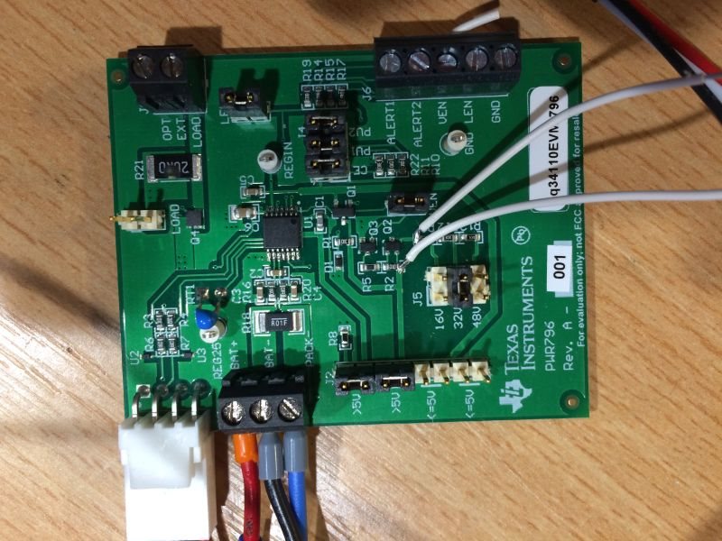

  • Hi Valentin,
    The log for the GPCCHEM tool should be run at room temp. Using 1S for the GPCCHEM tool will work well.
    With respect to the 8S configuration, the external jumpers will need to be utilized. Place the jumpers of the EVM into >5 mode and the divider jumpers to 36 V.
    Set the Series = 8 and VEN_EN = 1.
    Now calibrate the voltage in the calibration tab of bqStudio. This will automatically modify the voltage divider value for you.

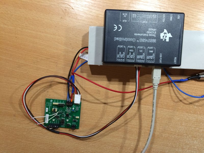

  • Hi Bryan,
    Thank you for answer, short summary - does not work for 8S config
    EV2400 arrived today, we currently have alredy 2x EV2300 and EV2400, after powering set-up on, looks it behaves the same (same issues), not responding to changes of "Number of Cells" neither of VEN_EN, IC on the board is ok, replaced with new one without functionality change. Photo of the setup attached.

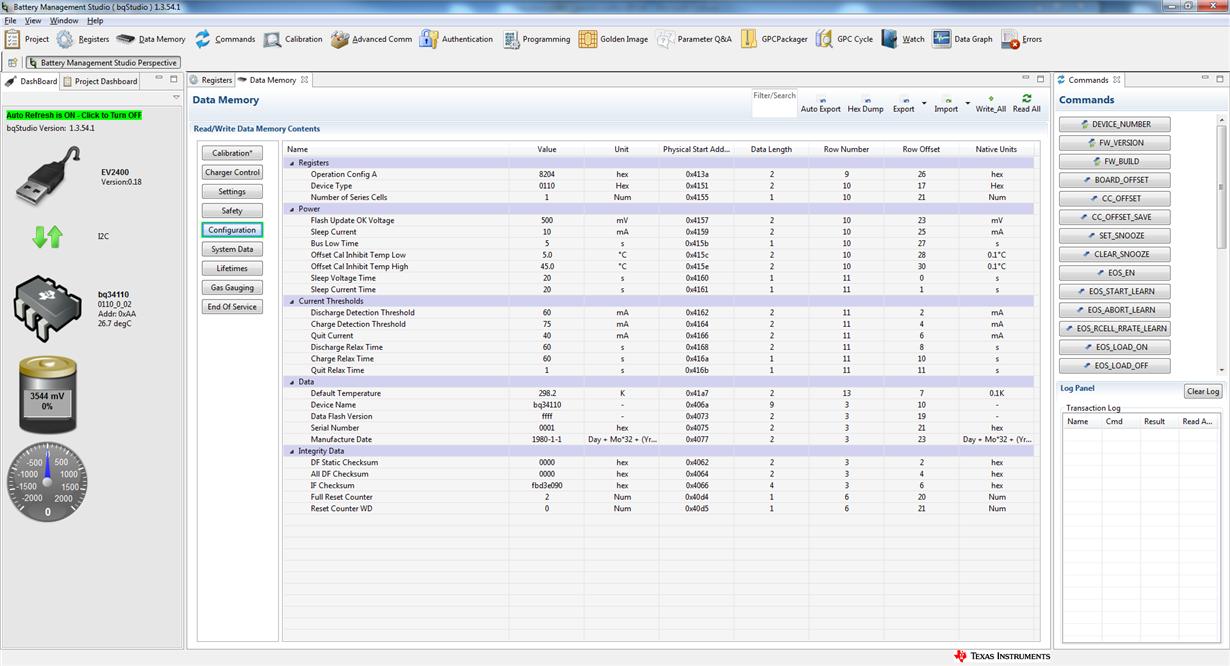

    BQstudio dashbord after starting, as you can notice there is no voltage indicated, this issue can be related to no voltage on measured bucesue dafultly VEN_EN is set to 0 (factory settings), I believe this is a reason, due to "Flash update OK voltage" - not documented
    if I connect two white vires to get VEN_EN working board indicates just 607 mV (below 1V as recommended), but still not possible tio update values in BQ studion:
    see notice at the bottom: "A read of datawritten failed comparision"

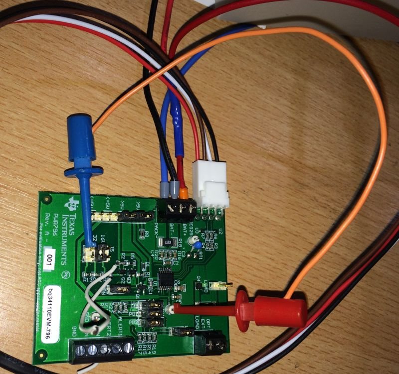

    Connecting REGON to divider output, increases voltage to REGIN value that is above "Flash update OK voltage" 2800mV, now it is possible to change settings
    connection on the board:
    afterwords I have changed "Flash Update OK Value" to 500mV
    now we change VEN_EN, BTW: it should be marked in bqstudio what colors means green 0, red 1, not to loook around...
    after disconnectionall artifical wires from board, board finally indicates voltage 3545 mV, No of cells is just 1
    now let continue with your recommndations step by step
    No of series cells changed to 8, written
    voltage remains the same, but setting cannot be changed again,...
    reading of values works, writting not
    i think there is serious problem with this eval kit type, I propose to check it yourself.
    looking forward hearing from you
  • Note: after trying again and setting of "Flash Update OK voltage" to 100 mV resolved the issue (definetelly eval kit issue for multicel config), now I was able to eneter correct values and calibrate, I have tried GPC cycle to grab initial measurements, but what mens EDV0 voltage (addressed i nseparate question) in case of 8S cell config and which parameters to set-up to GPC cycle knows battery is fully charged (becuse protection electronics already disconnected the pack but GPC cycle still ask to connect charger)? It looks for me one issue is just replacing another one ...
  • Hi Valentin,
    I'm sorry to hear about the issues you have experienced so far. You are correct in updating the "Flash Update OK Voltage". The default value for this parameter is too high when using the external resistor divider with a large number of cells.
    I see you have started another thread regarding the EDV0 voltage. Would it be okay to close this thread?
    Matt
