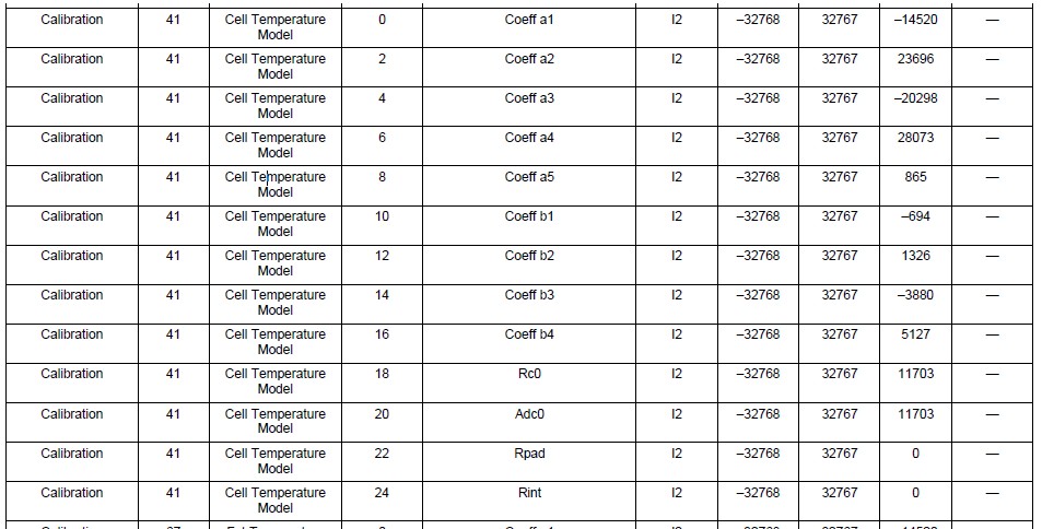

Would like to check if there is temperate coefficient model sames as multi-cell. If yes, is there a spreadsheet to get relative coefficients?
Help to post a question from one customer.
Hi Ake,
Pls see attached. I would recommend the customer avoids changing the thermistor from a 10k
thanks
Onyxntc_calc.xlsx
