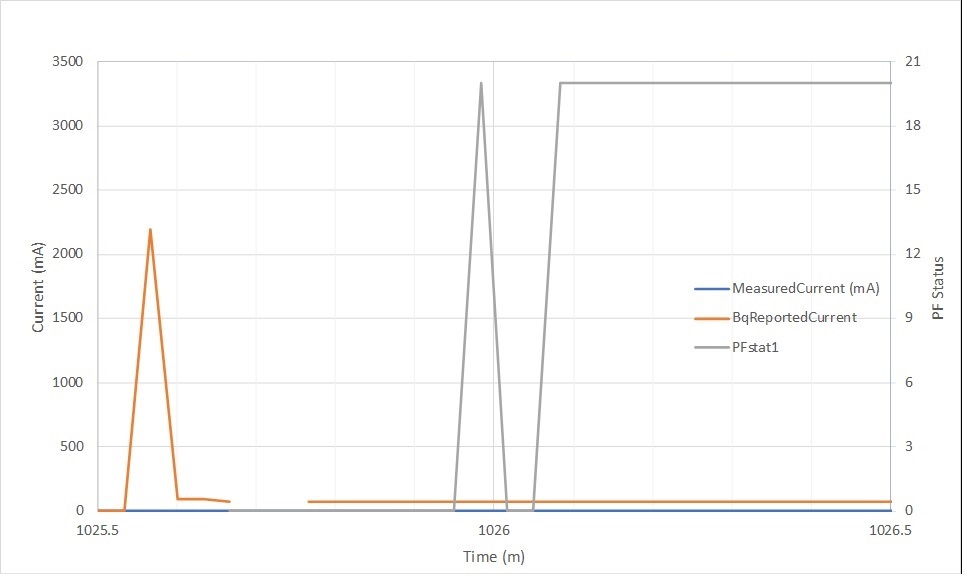

We under-charge some batteries in our product line.  Some chargers do not communicate with our batteries and are over-charged due to the settings in the gg file.  We were under the impression that when a full charge happens, the charge FET gets pulled (at some point) and no current can flow.  It seems that the charge FET gets pulled and we get a CFETF permanent failure, even with a 20 second failure time.
How is current still flowing where we get this error?
Is there any way to prevent this failure?
  • Hi David,
    I'm not so familiar myself with this device, will have to look into it more. Can you send a gg file with your settings, and a log showing the events you are describing? It seems your log should show a current > 20mA after the CHG FET is disabled for the CFETF to occur, do you know if this is happening (and why it would happen)? Are you using a ZVCHG precharge FET?
    Normal charging generally doesn't result in the CHG FET being disabled at full charge, that would normally occur when you have reached an overvoltage condition. You may have the CHG FET disabled if the pack is removable and is removed from the system ([PRES]=1).
    Terry
  • We do not have a log because the errors happen in the field.  The chargers that communicate with the battery, charge normally at 16.1V.  Some of the legacy chargers attempt to charge the battery to 16.8V.  In the lab, the battery's charge FET would turn off and the battery would be fine.
    Failed - Copy.txt

  • Thanks for the logs, please expect to hear from us in 2 days.
  • Hi David,
    Have you tried recreating a similar case with this pack, clearing the PF, applying the higher voltage charging voltage, and seeing if you can somehow recreate the failure? Given you have been in production awhile, some possibilities would be (a) malfunction/failure of the bq20z45, (b) malfunction/failure of your FETs, (c) board-level issue/fail. So it would be good if you can be working to narrow down to which is the issue, are you confident it isn't something related to the FETs or board?
    When you are seeing these fails, how long have the boards been in operation at that point? Are they failing early in their life or after some moderate usage by the end customer?
    Can you send the schematic?
    Terry

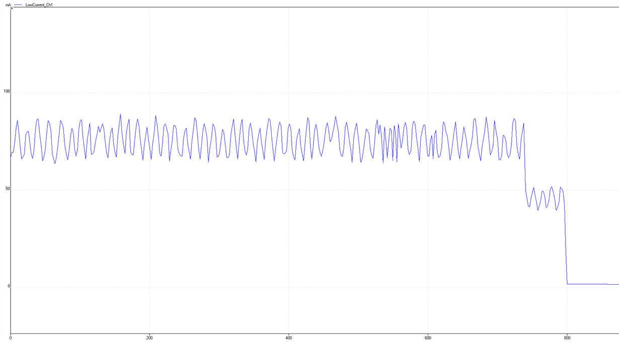

  • I am currently trying to re-create the issue on my bench doing exactly what you said. So far, there has not been a permanent failure. I am currently using a battery that has failed in the field. The FETs are working properly so far. I am not confident that there is not an issue with the board which is why I am trying all options. I do not fully understand the problem. It seems like if the FET was off, then there should not be any charge current. Can you private message me your email address so I can send you the schematic?
  • I looked through the schematic, nothing spiked out as an issue from initial review. Another possibility would be if the current measurement was corrupted somehow, so even with zero current, the device believes it is seeing current flowing. When you retest the previously failed board, is the current msmt still look accurate, with little/no offset?

    Here is the attached log of the battery failing on our power supply.  Do not mind some of the missing data in the beginning, our MCU was still talking to the bq part and turned it off at some point during the test.  It failed at line 4695.  You can see the FET go off when there was 3059mA of charge current,  20 seconds go by, the error trigger because there is still around 80mA of current flowing.  The current never goes to 0 after the FET gets turned off.  As seen in previous samples, the current is 0.
    With this being said, the new question is:
    Why is there current flowing if the battery is calibrated properly AND the charge FET is off, AND the charge FET is in a working, functioning order?

  • Just to be sure, can you measure the voltage across the sense resistor after the PF occurs, while the pack thinks there is 80mA flowing? That would tell for sure whether there may be "real" current flowing in that state.
    I've discussed with the rest of the team, if there is truly no "real" current flowing, and the calibration values are reasonable, then the only other item we can think of is if the device is damaged. Given it only seems to have started right when that brief interval of charging occurred, I wonder if somehow there could have been some damage incurred right at that point. Is your load inductive, such that it might get a large spike at the PACK pin when the FET turned off?
  • Also, it seemed to recover somehow, since you were initially having difficulty reproducing the issue in the lab. If this is the only one you have that reproduces it, I wouldn't "reset" it, since it may be useful for more experiments. For others that failed and were returned to you, what did you do to them before experimenting - did you only unseal and clear the PF, or something more?
  • There is no load, this is charge current that the pack is reading.  And I doubt that a large spike could be longer than 20 seconds.  But if there was a large spike, doesn't the device and support circuitry have the ability to protect itself?  20 seconds seems like a long time to me.  The pack is on a power supply (17.2V @ 3.5A).  The power supply is attempting to give it that much power when the charge FET is opened.

  • We were able to get the battery open and have the correct tools to measure the sense resistor when the battery failed.  There was no real charge current flowing.  See the attached log (failed at 1576).

  • Thanks, so that removes that concern. Another item we noticed in looking at the schematic more - since you have the gauge VSS tied to the pack-side of the Rsense, which means that any current drawn by the gauge will flow through that Rsense and thus be measured by the gauge. However, normally we'd expect the gauge to be drawing current, thus causing discharge current, plus your measurement showing zero current even while the device is reporting 80mA doesn't explain this.
    Any corruption of the calibration data could definitely cause the gauge to think there was current flowing. From our quick calc, your board offset only accounts for maybe a ~5mA change in measurement.
    I notice in your schematic that the 3.3V is generated by an LDO at pack-side, so when DSG FET is off, I assume that rail disappears. Do you overdrive that rail from the charger while the FETs are off? Otherwise I don't see that you could talk to the device, since the SMBus is pulling up to that rail.
  • Ok, too bleary - the charger attach is still powering the LDO, so the rail and MCU are powered while on the charger.
  • You are correct. The 3.3V does disappear when the discharge FET is pulled. I power the rail through a custom board that we made in house using J9 (J9-1).
  • Regarding the spike, I was referring to a possible short spike (ns or us) that may have occurred right when the FET turned off, and whether that could have triggered something (not a spike of 20sec in length). Given the device recovers well, it doesn't seem like permanent damage. Is it possible something caused a corruption in the RAM values in the device, even though the DF still has the correct calibration data?
    Your latest log shows a continual charge vs COV, with the ~90mA when the charging stops. I see some odd data earlier, such as around line 896-899, where the current dropped from 3A to 93mA briefly, although FETControl shows both FETs are still on. Do you know what might cause this? Is this your voltage source or something with the device?
  • In entry 894, I see the FET go from 6->2.  Then entry 895 have a current reading of 91mA.
    We are using a regular power supply and are not doing anything abnormal (as far as I know). (Leader 790-3D, 30V 3A supply.)

    We ran a test over the weekend with the following setup:
    - 2 batteries sitting on a charger that originally caused this failure (prior to Jervis re-creating on power supply)
    - logging every 2 seconds w/ the BQ software
    - logging every 2 seconds the current across the sense resistor with opamp circuits.
    The purpose of this test was to validate what an external circuit is reading in comparison to what the Bq is reading.  One would think that if the BQ part is measuring a current above x milliamps for > 20 seconds, then another should measuring the same points should capture the same thing.
    Both packs went into the CFETF perm failure, one after about 6 hours and the other after 17 hours.  Below are the graphs with the comparison.   At the time of the CFETF failure, the BQ's measured current did not drop down to ~0mA (it was about 80mA of Charge Current) while the Opamp (diff amp) measured roughly 1.7mA.  Please see below:
    Mike

  • Batt/Terry
    Regarding the test data I sent in on 8/20, I setup another current measurement test.  Instead of measuring the current across the sense resistor directly (as I did with the data from 8/20), I measured much closer to the BQ part.  I did this in order to determine if any noise was getting picked up along the sense line that was causing some sort of false current reading.  This has been running for roughly a week all together, and the failure has not occurred.  However, we noticed something that I found interesting.
    When we wrapped up the testing on 8/20, the packs were both in a CFET perm failure.  I took one of these packs and de-soldered the top of the battery pack from the PCBA (Batt +).  I de-soldered my opamp circuit across the sense resistor and soldered it to two components much closer to the BQ part.  Next I re-soldered the Batt + to power the pack back up.  In this process, I happened to have the logger running while I went to exit sealed access, clear the PF, and reset (0x0041).  During this time I was measuring ~80mA of charge current (sitting idle on my bench), which went away completely when the pack was finally cleared of all of the above.  See graph:
    At one point it dropped from roughly 80mA, down to just under 50mA.  I believe this happened when I exited sealed access mode, but it it could have been when I cleared the PF.  At the end, everything dropped back down to 0mA.  I found this interesting because there looks like there is current flowing at that time, I just can't determine the current path unless it is internal.  What is also interesting is that the 80mA wasn't shown at the end of the data from 8/20, so I'm not sure if something I did caused this or not.
    Let me know what you think of this data
    Thanks, Mike
  • Hi Mike,
    To clarify, is this logger data obtained by reading the bq20z45 current value, or from equipment monitoring your external opamp circuit?
    Terry
  • Terry
    It is from other equipment (Picologger). I couldn't do the BQ logger because I was trying to reset the PF from the first test. After everything was cleared, I turned on the BQ logger.
    Mike
  • Hi Mike,
    Ok, I am assuming your picologger is capturing the output of your opamp circuit, correct? Thus this then looks like a real signal on the board, not just the gauge reporting a fake value when the actual board-level current is zero.
    An 80mA reported current across the 5mOhm sense resistor would result from measuring a 400uV level. With your opamp moved closer to the gauge and now seeing this, it makes us think you might be getting some unexpected current injected on the gauge-side of the sense resistor filter network. The filter network has 100-Ohm resistors isolating it from the sense resistor, so a 4uA current across that filter R could also generate a 400uV level.
    If it was a consistent 4uA, then you would not have it change when you clear the PF and reset, so it seems somehow that these actions are triggering the change. When you are in PF and are measuring this current, do you still have the 17V charger voltage attached? If so, does it change the reading when you remove the charger voltage?
    If it is still attached, when you clear the PF and reset, I assume the CHG FET may turn back on, is that true? So that turn-on could be triggering something that leads to this current.
    Are you using a real battery pack in your experiments, or something generated from a supply? If from a supply, can you measure the current flowing from the supply into the board, as well as the current flowing from the charger into the board? Just to be sure there isn't a "real" 80mA flowing anywhere, that should be easy to measure (it may be harder to measure an extra 4uA, though).
    Terry
  • Hi Mike,
    One question came up in looking back at this data - why was there not a 2A-3A measured current spike in the upper plot? Was this just a sampling issue with the equipment? Or was it maybe earlier in time than is shown in the plot?
    Terry
