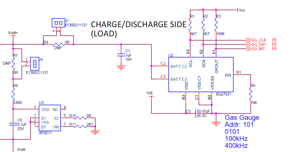

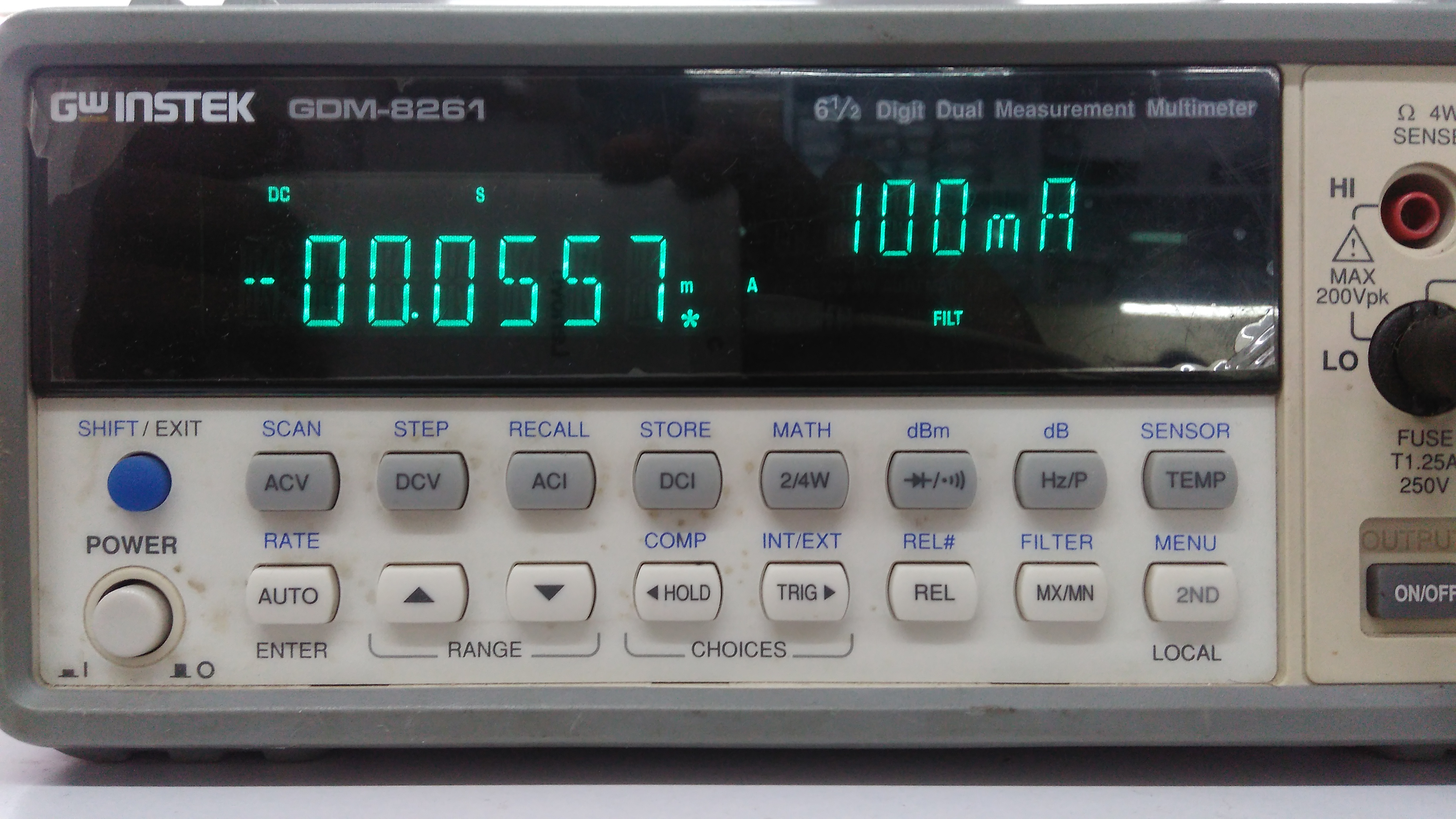

We are using BQ27621 Fuel gauge IC for our prototype design which is battery operated. We have put the jumper to measure the current consumption of the IC. We found that as per datasheet, it should consume 27uA current in normal/active mode but using 6 1/2 DMM we measured that current around 56uA. So we don't know why it is consuming this much of current.
Will you help me to understand how and where this much current is going?
Here I have attached the schematic snap of the IC and the measurement point is jumper J1.
